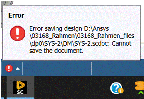

      Hi everybody!
      sometimes when I want to save my design in SpaceClaim I receive the following error message: Error saving design *.scdoc: cannot save the document. After 30min more or less I can normally work again and save the document.
      I re-installed again the software and I had no problem during almost 5 days but now the error message appears again.
      Any experience with this error message?
      Thank you!
      Diego

      Hello Diego,
      Try resetting your options. These are kept in place even when uninstalling.
      Go to File > SpaceClaim Options > Advanced > Reset All User Settings.
      Try Deleting the contents of %appdata%\Local\SpaceClaim.
