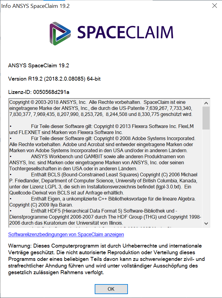

thanks for your reply. I have read and write permission for those files. The error says: "Fehler beim importieren von "[filename].stp""("Error during import of "[filename].stp""). Attached you find a screenshot of the filetype dropdown menu during the "file menu -> open" import process. The STP format is not listed.

April 8, 2022 at 12:24 pm
Devendra Badgujar
Forum ModeratorHello Hans Hohensee
Please can you confirm if you have a SpaceClaim Engineer license ( Serial number based - FLT ) floating license ?
You can check what license type you have by launching SpaceClaim and going to File>SpaceClaim options>Resources>About>License Id.Â
Please send us a screenshot of that page.

April 8, 2022 at 1:08 pm
April 8, 2022 at 2:07 pm
Devendra Badgujar
Forum ModeratorHans HohenseeÂ
When you first launch this SpaceClaim R19.2 installer, there are two buttons. One is called SpaceClaim, and the other is called SpaceClaim Translators. If you did not run that 2nd option, try doing that. The most common reason for missing file type options is overlooking that translators button in the install menu.Â
Please let me know if any further assistance is needed.
Regards.
April 11, 2022 at 3:24 pm
hans.hohensee
SubscriberDevendra BadgujarÂ
You were right, I forgot to install the translator. Thanks for your help!
