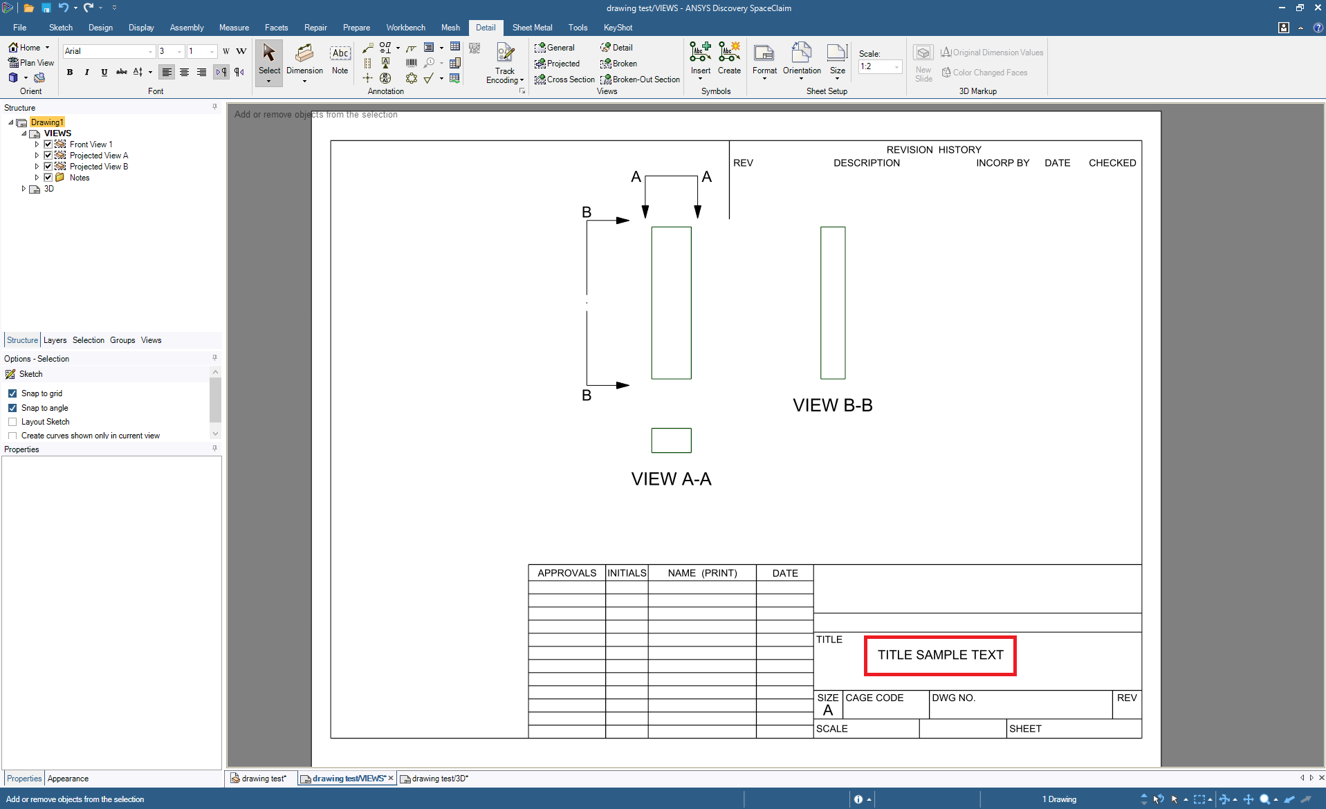

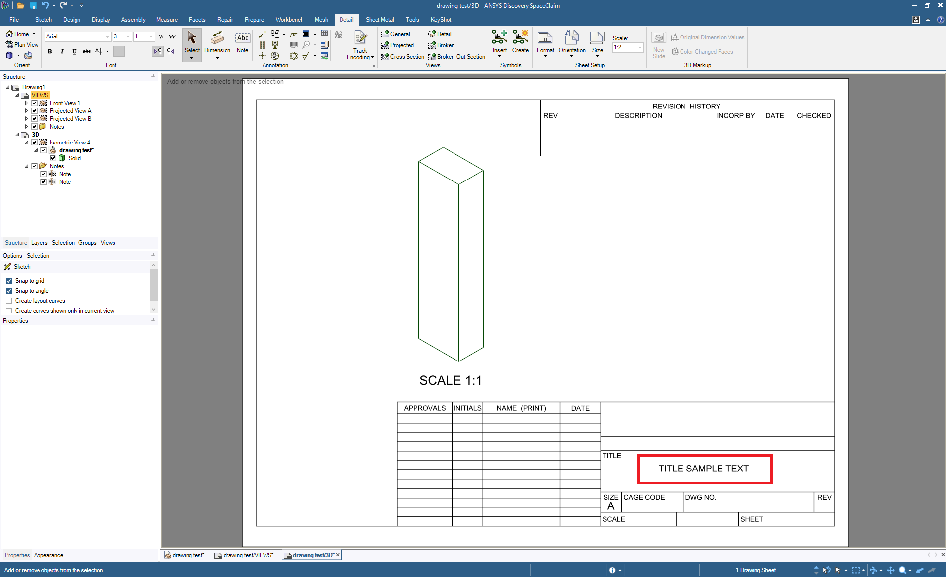

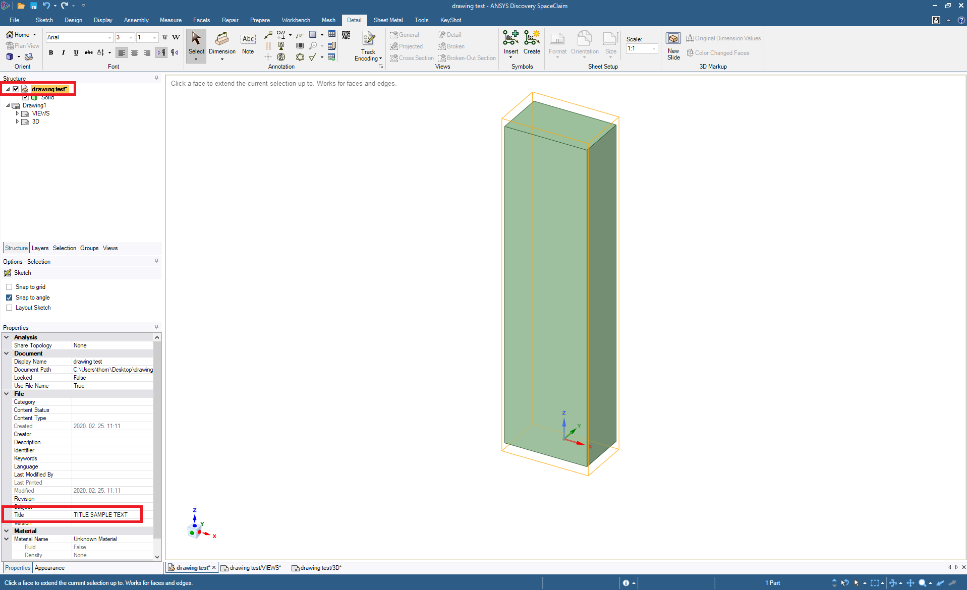

1) I added a Note with "Insert Field" method (XXX icon inside the Note pop up window) to my drawings. How can I quickly set e.g. the Titles for different drawings separately? If I select the file top of the Structure Tree, I can type in the Properties panel (e.g. to Title cell) but this information will appear on all drawings. It would be good to set these Properties for each drawing sheets separately. For many drawings it is a time consuming procedure to open the sheets and add a Note one-by-one (without the Insert Field method).

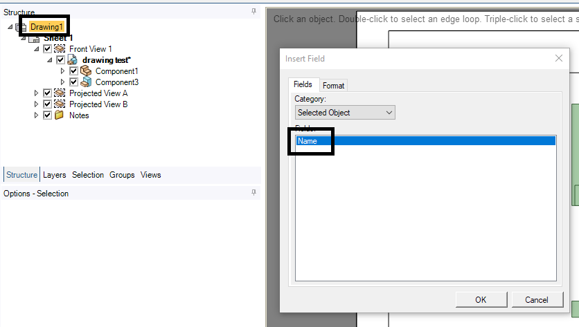

- You can create a Note in the template and right-click to select the symbol as shown in below image.Â
This will allow you to set a parameter to display.Â
For example, Clicking on 'Drawing 1' as shown in the below image will suggest the parameter 'Name'.Â
Selecting this will display the name in the Note.

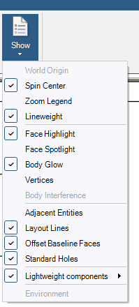

 - Lineweights in Drawing sheets can be adjusted from the SpaceClaim Options> Detailing> General. Scrolling down you will find the line weight options.Â

1) I did it now but when I rename "Drawing1", the Note does not update automatically.
It would be great to set Properties for each drawings separately (same way as for the File, see bottom left on the first picture in my original post). In this case one could click on a drawing and a Properties panel could appear on screen with the rows e.g. Creator/Description/Last modified by/Revision/Title etc. Now when I click on the Drawing in the Structure Tree, the Properties panel is blank.
In reality when many drawings (not sheets!) belong to a model (and to different parts in a model), there may be different Creators/Revisions/Titles etc. separately for each drawing. (A drawing can consist of multiple sheets. In this case it is obvious that each sheet has the same e.g. Title or Creator).Â
Summary: It would be good that one can set Properties specific for each drawing with the intelligent, self-updating Note (I mean with the XXX-symbol, which you mentioned too). It would be good that if I want to give another drawing a different name, I just open the Properties specific to that Drawing and I type in a new name in the Title row. Now it does not make much sense to set Properties for the File itself (and not for the drawing/sheet) and to display these Properties with the intelligent Note, because these Properties will appear on all drawing templates.

3) I know that. But can I somehow already display the configured lineweights in the Drawing space? I don't want to print the drawings just to see the correctness of the lineweights.

The line weights are reflected on the Drawing sheet, is there any issue you face with regard to this? Can you please share a screenshot so that I can understand it better?
If you would like to check how they would turn up in print, you can check the Print preview before printing. -

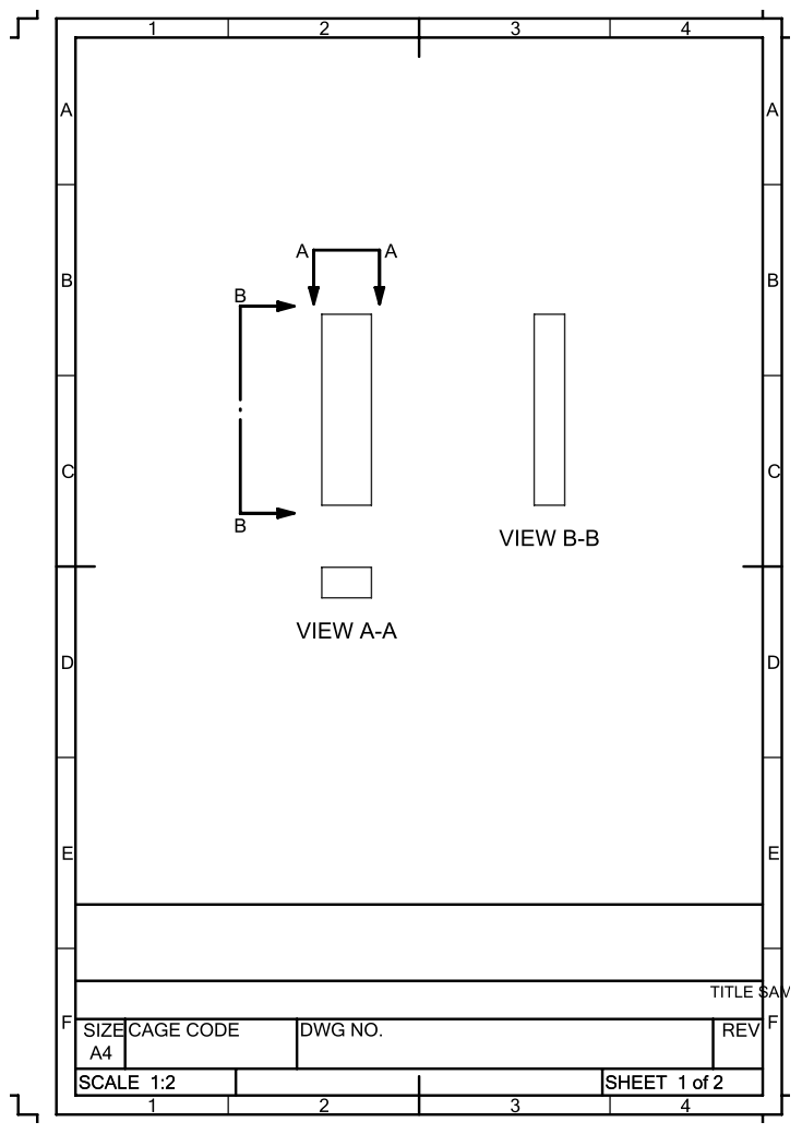

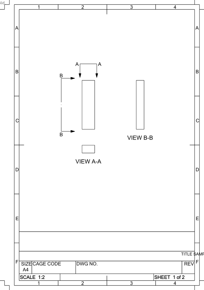

Lineweights: In the drawing space (not in printed PDF) there is only one lineweight displayed for all lines (see first screenshot). But in case of printing it can be seen that the arrows and drawing frames have bigger thickness (see second screenshot). The question was: Can I somehow turn on the lineweights in drawing space (like in AutoCad there is a "Show/Hide Lineweights button for this)? Then it would be easier to check the lineweights inside the drawing space instead of always clicking on Print->Print preview...Â
