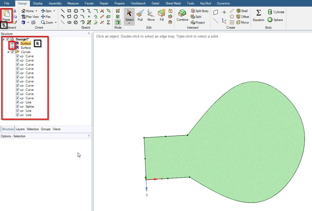

    • anchel
      sorry, I can not upload the video (I dunno which video extension is allowed) I copy some pictures
    • raul.raghav
      Refer to the attached images to check if that is what you want.
    • anchel
      Thank you so much Rahul for your anwser.
      I see that it is not straightaway but your procedure is valid for me. I could not understand how spaceclaim generates automatically the surfaces even if you do not want.
