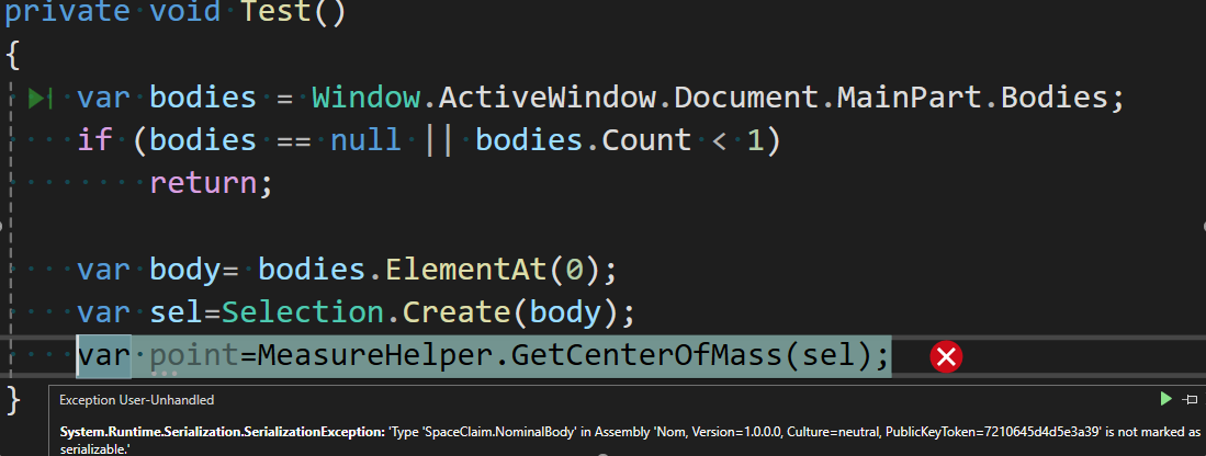

3)I can't find in SpaceClaim.Api.V21.dll analogs of methods from phyton MeasureHelper class, such as GetCenterOfMass(), DistanceBetweenObjects() and others. I have connected SpaceClaim.Api.V21.Scripting.dll and I tried to use these methods, but some kind of exception related to serialization is thrown.
To solve 3 issues, I use Application.RunScript(path, args, out res) from c#, but it is very inconvenient and slow to work

Forum ModeratorHi Alex,ÂÂCan you please share the screenshot or the error message that comes up in 3rd question?Let me check the other parts of the question and get back to you. ÂÂThanks and RegardsAtharv -

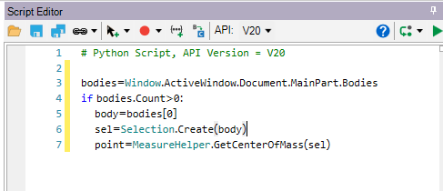

SubscriberHi Atharv.
This python code works:
This same c# code throws an exception on the last line:
Exception text: "System.Runtime.Serialization.SerializationException: 'Type 'SpaceClaim.NominalBody' in Assembly 'Nom, Version=1.0.0.0, Culture=neutral, PublicKeyToken=7210645d4d5e3a39' is not marked as serializable.'"

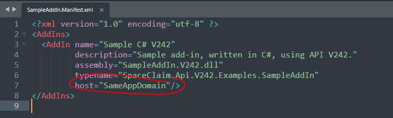

If the add-in uses the same AppDomain (this is set in the manifest.xml file):
Then you can add a reference to the scripting dll (should be located here: "C:\Program Files\ANSYS Inc\v241\scdm\SpaceClaim.Api.V242.Scripting.dll") and then they can make the same calls as scripting.Â
Please check if that helps accessing the call for GetCenterOfMass().

January 16, 2024 at 1:28 pm
user deleted
SubscriberHi Atharv. It works, Thanks!!!Â
