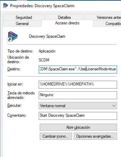

I have followed the steps in the manual and it still doesn't work, I am detected by KeyShot 8.2 not KeyShot 9

Can you please send a snapshot of the properties panel with the modified 'target' field as mentioned in the solution pdf (refer image for reference)?

This generally shouldn't be the case. I will talk to my teammates and find out what might be the issue and will get back to you soon.Â

The steps I had suggested works for every version of KeyShot except for KeyShot 9. KeyShot 9 is not yet not supported by the 2020 R1 version of SpaceClaim, and this issue will be sorted in the next version of SpaceClaim.
Sorry for the incorrect initial assessment of the query and sorry for the inconvenience.Â
