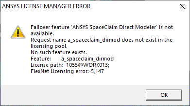

SubscriberHi, as far as I know no extra licenses are necessary to import CATIA V5 parts. But why do I get The required license is unavailable, when attaching a CATIA V5 part? I won't get this error when importing the same part in SpaceClaim 2020R2.I have a Named User Subscription (Node-locked Licensing: 1 month Test).Any ideas? Did ANSYS change something regarding licensing between those two SpaceClaim versions? Cheers -

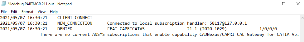

Ansys EmployeeUnder the %TEMP%.ansys directory you should see a file named: licdebug.SPACECLAIM.211.out
Can you please post the contents of this file as we are not permitted open files.
May 3, 2021 at 10:42 am
May 3, 2021 at 12:38 pm
George Karnos
Ansys EmployeeCan you paste the contents here?
Also, are you sing an Academic version or Free Student version?
I believe if you are not using the Free Student version, you would need a "ANSYS SpaceClaim Catia V5 Interface" license.
Can you also paste the contents of your license file?

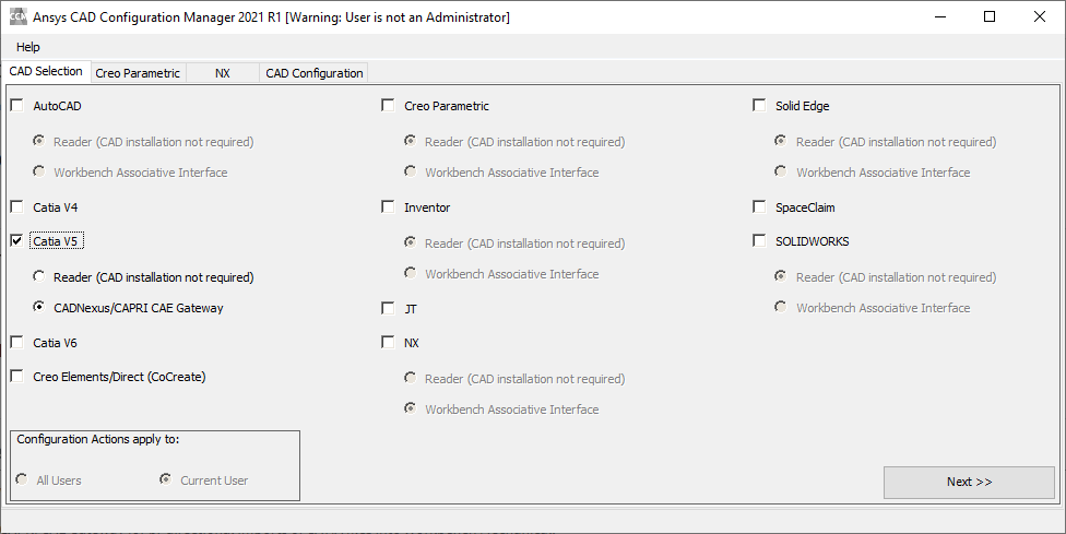

SubscriberThe CADFEM support was able to help me.
I am using CADNexus CAPRI CAE Gateway for bi-directional imports of CATIA files into Workbench Mechanical.
This interface is set as the default reader at the CAD Configuration Manager:
When trying to import CATIA files into SpaceClaim, it will try to import the file through the CADNexus interface, which fails:

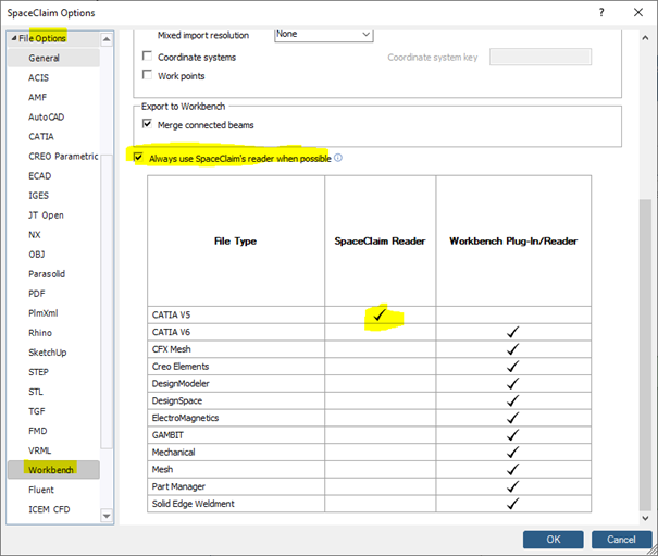

C:Users***AppDataLocalTemp.ansysTo be able to import CATIA files into SpaceClaim with a Subscription License only, following setting is necessary:

SubscriberIssue solved. : )
Thanks a lot!
Have a nice day!
