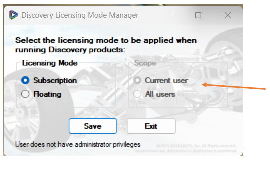

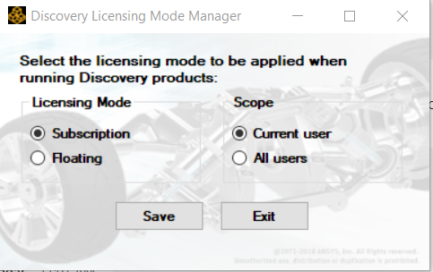

You need to launch this with Administrator rights and then make the changes.

I started the program with Administrator right and also face the same problem. The login prompt still didn't show out. Now only can use the software as view mode only. Pls advise.Â
