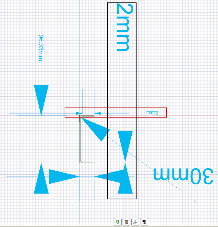

        Hi, I'm in "section mode" and I have actvivated a plane in order to make "annotation dimension". But I don't understand how to modify the annotation setting. Is it poossible to modify annotation setting ? Please see my picture: In red, what I want by default. In black, what I have.   Regards.   Daniel

      Hello dNouxet
      I hope I understand correctly from you your image that you would like to change the text and arrow size in your annotation.
      You go to File> SpaceClaim Options and under 'Detailing> General' Annotation options and Linestyle options, you can customise them as required.

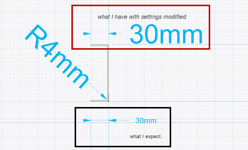

      Hello Subashni Thanks for you answer. I have tested the method. It's right for arrows concern, but I don't understand how modify the text. I modify the 'Default text height' without modification.   On a same topic: is it possible to modify the settings by C# thanks to API ?   regards. Daniel

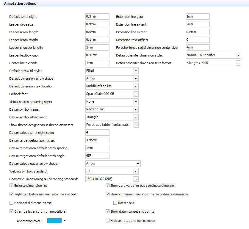

      Hi Subashni , I tried to modify the value 'Default Text Height' without result change:
    • subashni.satish
      Hello dNouxet
      You can also modify the individual text height from the mini-toolbar, by right-clicking on the Text box.  Or select the text box and modify the text height from the Details tab> Font panel.
