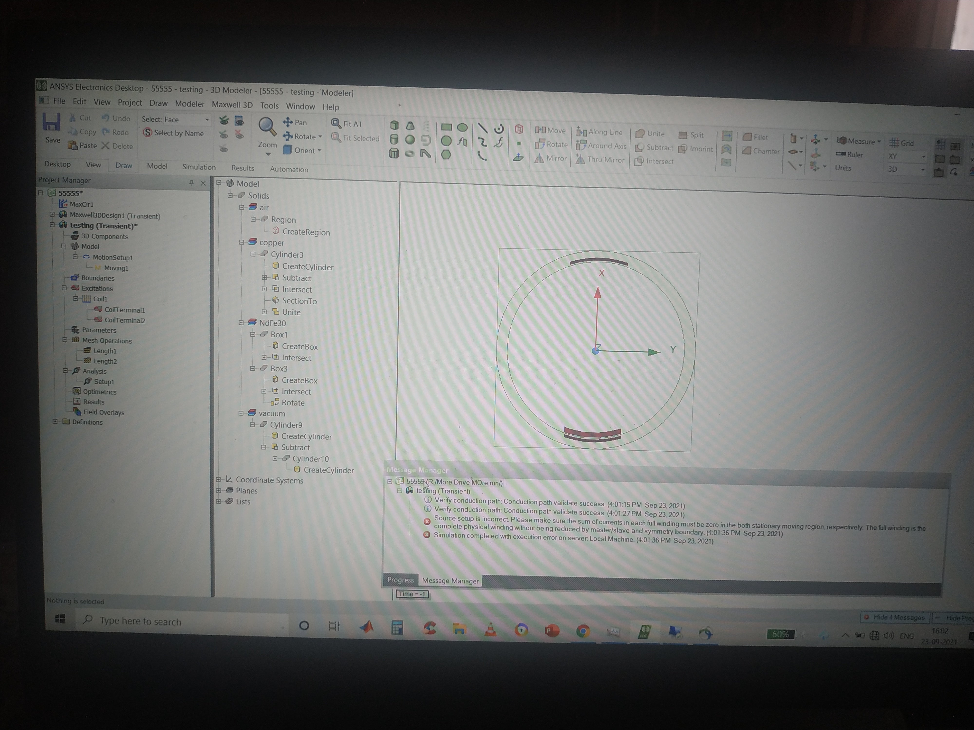

I tried simulating model on 3d transient analysis with Magnet (blqck)rotating and conductor (brown) Stationary. Band assigned with 120segments (yellow color). Assigned external circuit with zero current. No excitation to magnet. No master/ slave
But getting error as
Source set up is incorrect. Please make sure that sum of current in each winding is zero in both stationary and moving region.

Forum ModeratorHi @Prashant5295 I see in the picture there is only one conductor. How did you define the excitation for this conductor?
What do you mean by there is no excitation to magnets? Did you assign magnet material?
Explain the necessary steps in detail with screenshots to interpret the problem correctly.

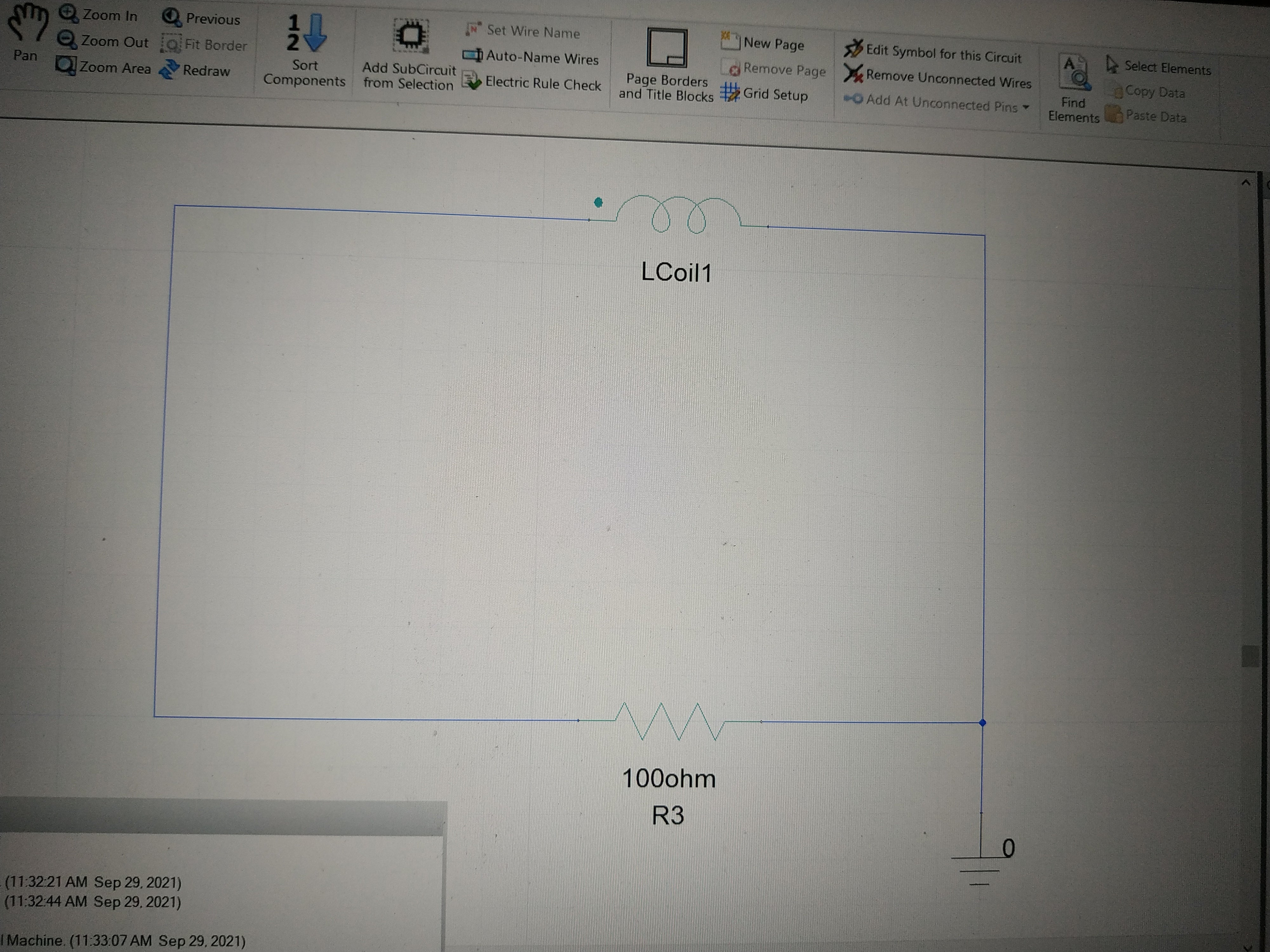

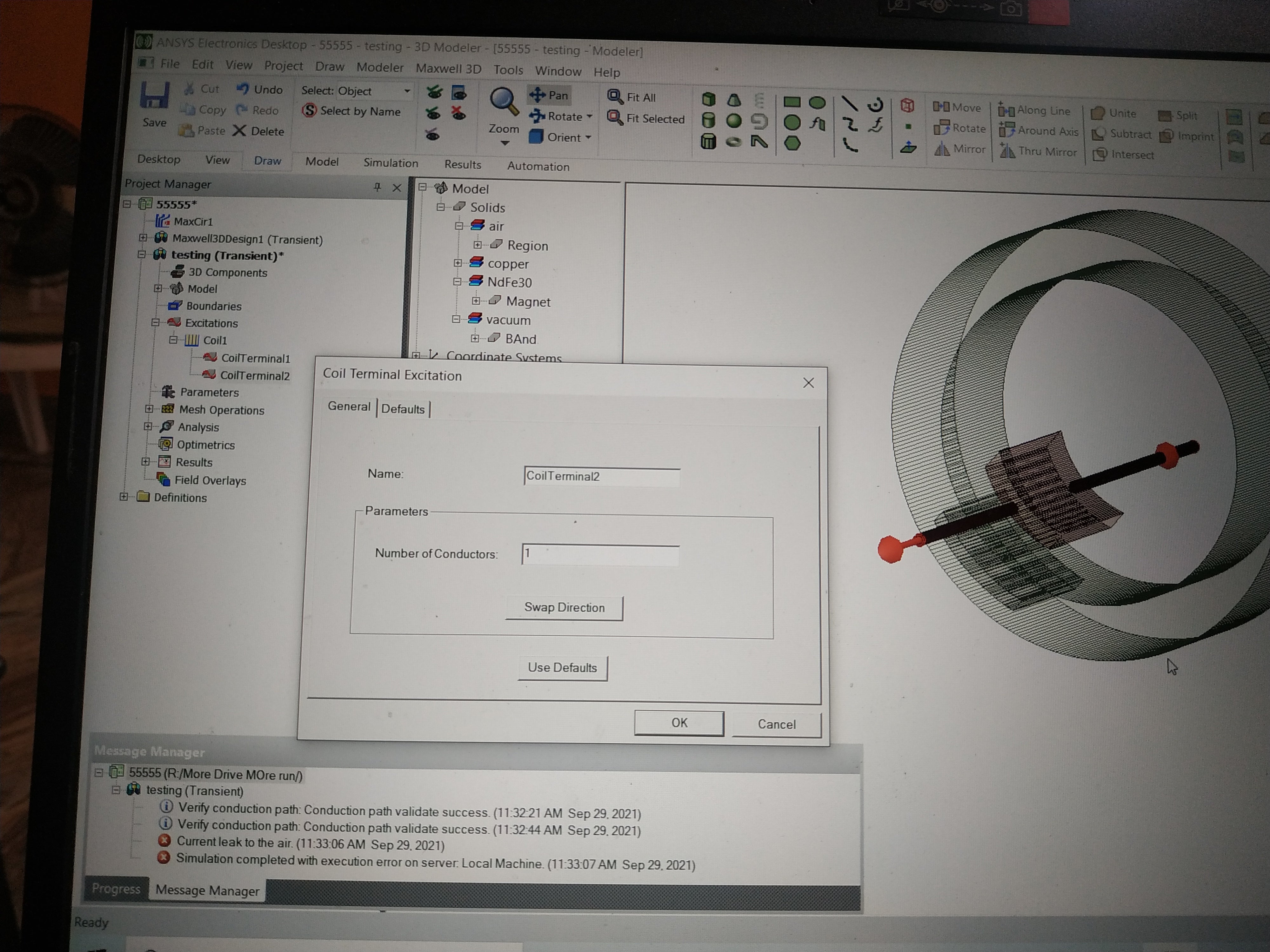

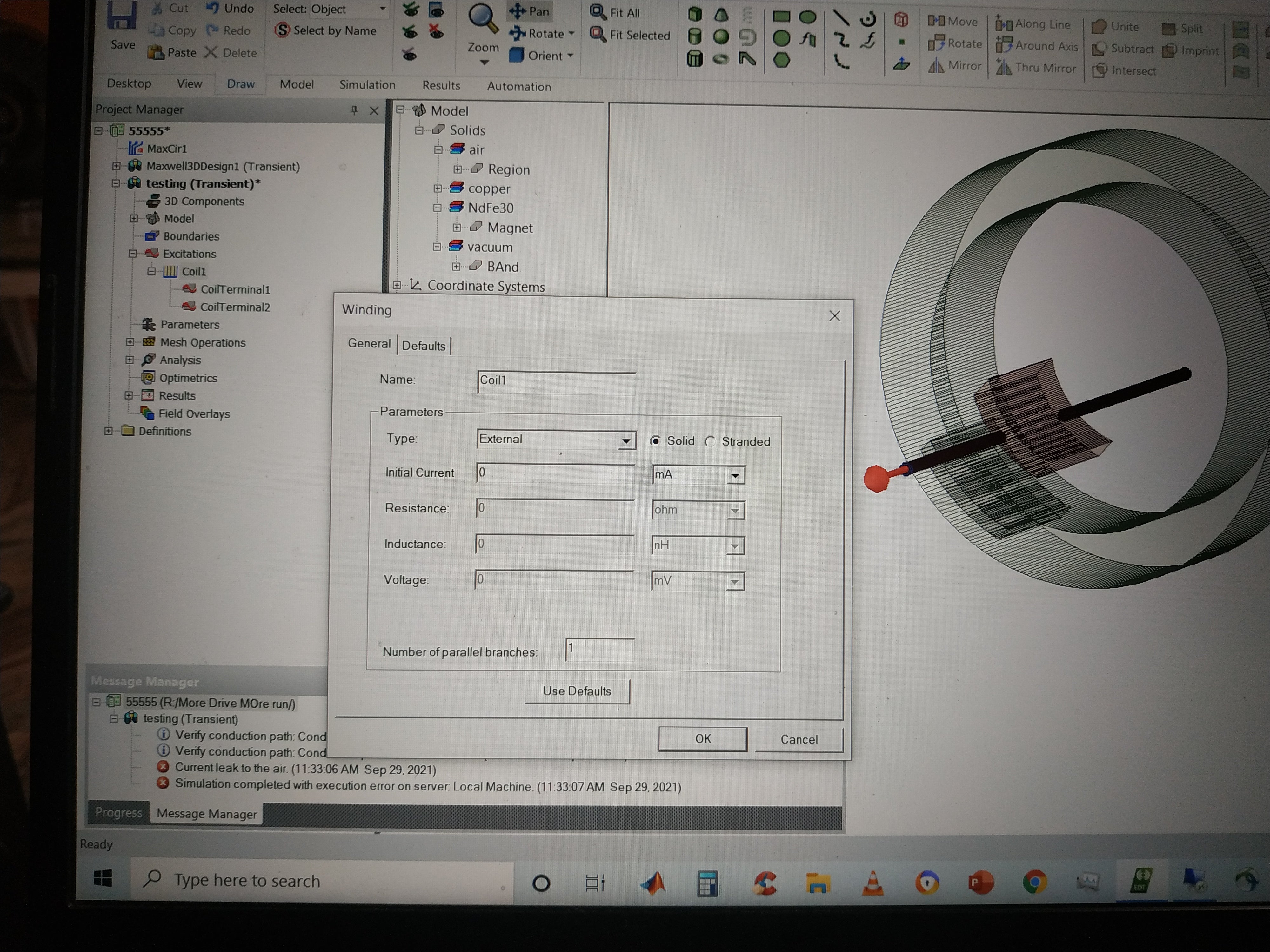

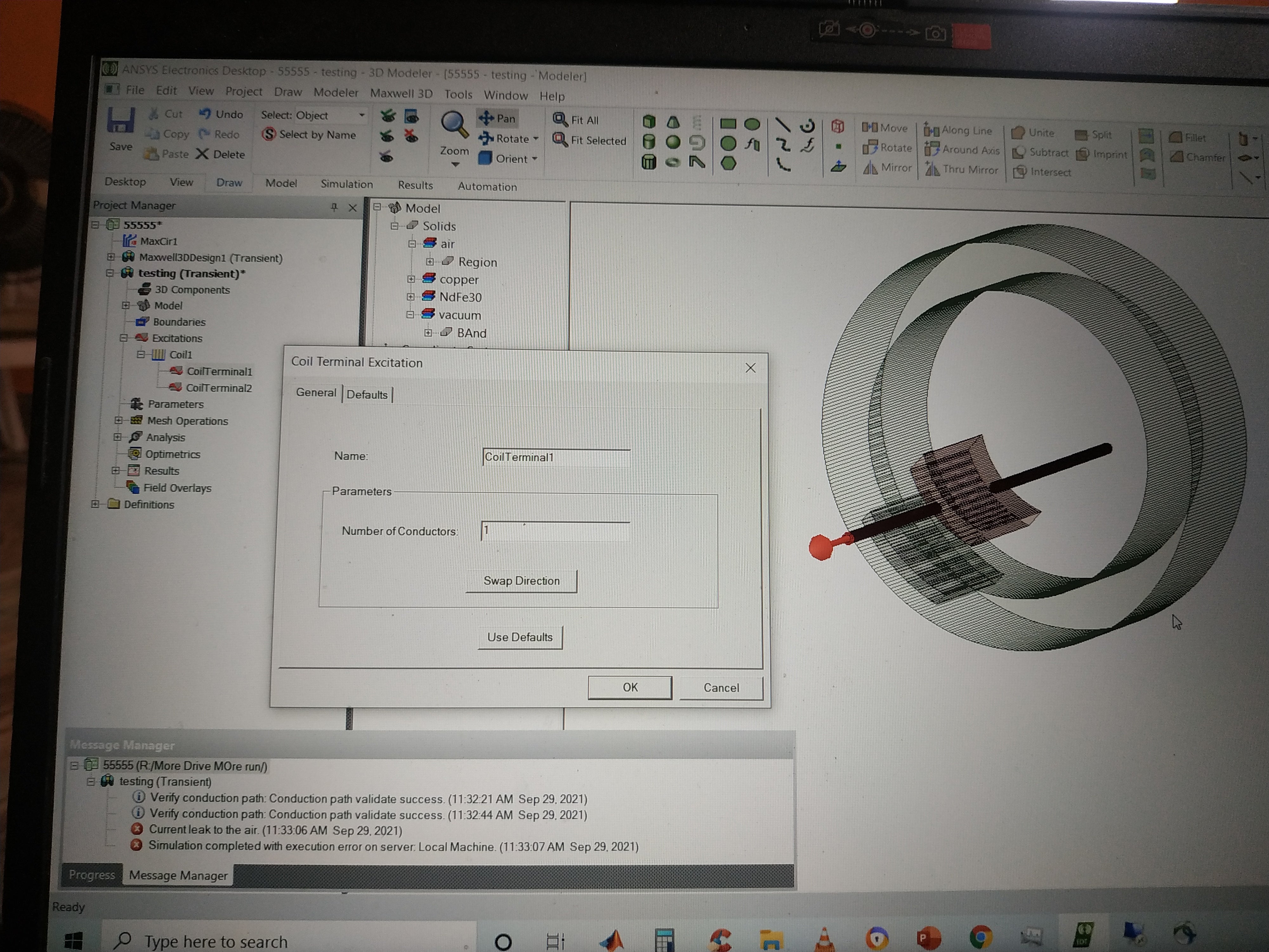

Current is assigned with coil terminal with zero current. To find induced voltage when magnet rotates.
I had linked circuit to coil terminals which was successful linked.
Earlier error was regarding true surface of band. Now error is air leakage.

Ansys EmployeeHello,Â
Please make sure that the coil terminal is not assigned on an outside face of the conductive object. It should be assigned to a cross-section on the inside of the object.Â
