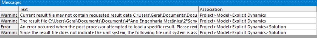

SubscriberHi! I´m using the student license to solve a simple problem in ansys explicit dynamics. After define all the conditions needed and solve my problem, it always appears the same errors:

Can you please go to solution information and check the error message in worksheet. It will give you better idea about the post processor error.

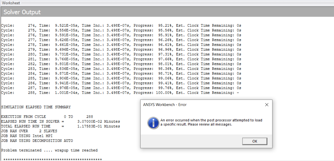

May 3, 2021 at 1:05 pmMay 3, 2021 at 1:34 pmAkshay Maniyar
Have you checked for error messages in worksheet?
Please check for error and warning messages in worksheet. (You can use Ctrl + F and then search 'error'). So that you can get more information about the error.
I have attached the image for your reference, how it will look when you search for error message.
Regards
Amaniyar

Ansys EmployeeThe cause for such errors could caused by as follows,
If you open an file from the Archive or from unsaved solution information workbench file you may face such postprocessing errors. You may need to clear the solution and re run the entire model again and see if you face this error again.
I have also found that your cycles are limited to 288, is there any specific reason ?, Lower cycles mean shorter solve time on the cost of accuracy. Adding to this, your simulation was not a fail, it can be decoded from message- Problem Terminated--wrap-up cycles reached.
If you want your simulation to be faster you may need to opt for geometric simplification, Mass scaling or Hardware improvement, I suggest you to not to decrease the Cycle count , comment down your response on the outcome and for better help.
