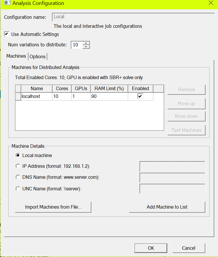

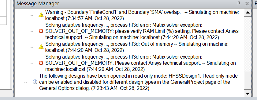

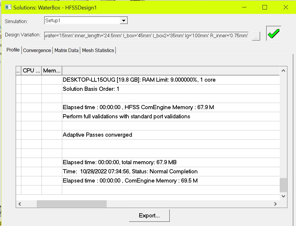

SubscriberHello, I'm designing an antenna using HFSS, when i start analysing the set up(Parametric Analysis) , a 'Solver out of Memory,Verify your Ram limit' error appears , although my PC has 20 GB RAM limit ,has an enough availabe storage too and has 4 cores.
I checked the HPC Options and the RAM limit is set to 90% and the cores up to 10 cores, but the solution data shows that the RAM limit is only 9% and it is only 1 core as shown in the figures below, so how can i solve this problem,since I've tried changing the frequency ranges but still the same error appears.Â

You say your computer has 4 cores, but in the configuration for localhost, I see 10 cores configured. It should be 4.
Also, you should set the number of GPU to 0 since your computer doesn't have a GPU for computation, only for display.
