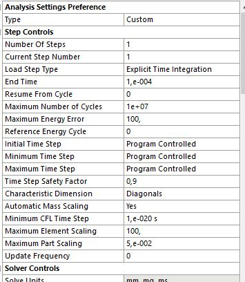

Im trying to simulate a frontal milling process and im facing the error: solver error time step too small
ive already read lots of discussions and none of them helped well.
follow below some screens of my analysis
September 28, 2020 at 5:54 pmMissy Ji
Ansys EmployeeYou can add some mass scaling, you have the Minimum CFL time step as 1E-20, which equivalent to not using mass scaling.nSeptember 28, 2020 at 6:23 pmChris Quan
Ansys EmployeeSince you are simulating milling process, it is possible to have material failed and mesh distorted in the milling process. Make sure failure criterion is added to the material to accurately predict material strength and erosion control is on to remove distorted elements.nSeptember 29, 2020 at 1:50 amluandersoncosta
Subscriberhow do I add mass scaling? ive already set that option to Yes befor, and the error persistednSeptember 29, 2020 at 1:52 amluandersoncosta
SubscriberI'm a beginner at ANSYS analysis, how do I add a failure criterion? nOctober 2, 2020 at 4:02 pmmrife
Ansys EmployeeHi. Regarding the Analysis Settings Details. The Initial and Minimum time step size are set to 'Program Controlled'. The Minimum time step size will therefor be defined as 1/10 of the initial time step size. You can manually change the minimum time step size. From the screen shot you provided the initial time step size was somewhat less than 1.527E-8. nFor more information on adding a failure criterion, please start here; Ansys Help -> Mechanical Application 2020 R2 -> Explicit Dynamics Analysis Guide -> Chapter 2.10.1.5 Explicit Dynamics Erosion Controls. Some of the failure criteria are defined here. Some are activated here but are defined elsewhere, for example a failure criteria defined in a material model.nViewing 5 reply threads- The topic ‘solver error time step too small’ is closed to new replies.
