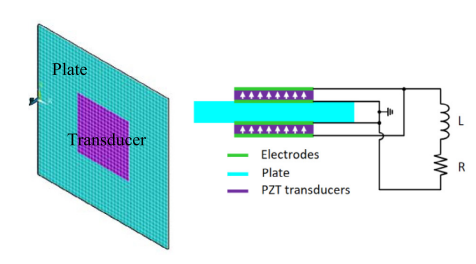

ive been trying to model a an aluminium plates attached to piezoelectric shunted circuit (https://doi.org/10.1016/j.ymssp.2018.04.041) using coupled field harmonic-mechanical in ansys. I model piezoelectric patches to be solid226 elements with electrical DOF using command APDL sniphets( ET, matid, solid226, 1001). In addition ive also added fixed support on all sides of the aluminium plate, grounded the inner sides of the piezoelectric patches, added pressure of 1 Pa to one side of the plate.Â
In order to model the shunted circuit, ive additionally added a command APDL, basically coupling top surface and bot surface of the piezoelectric patches' electrical DOF to a terminal node; adding resistor in the circuit element and finally connecting circuit across top and bottom terminal node, APDL:/PREP7 Â Â Â Â Â ! Enter preprocessor

i dont know why solve is ignored in this case, should i have approached this problem the other way? -

I take it the commands object listing is the CO that is attached to the coupled field harmonic environment (and not either of the two on the geometries). The commands are inserted to the input file AFTER the /solu command that Mechanical writes. So you need to reenter /solu at the end of the commands object. I.E. here:
! No /STATUS or /SOLU here - Workbench handles that
FINISHInstead use:
FINISH
/solu
mike
July 21, 2025 at 10:51 am
jeremysawzy03
Subscriberthank you so much it worked!
