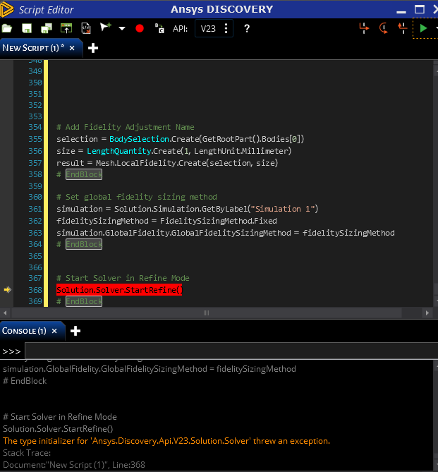

    • Karan Bhuta
      Hi Devendra,
      This is what it looks like when i try to run it. I have used indexing variables isntead of smart variables. Even without the fidelity adjustments, it used to throw the same error.

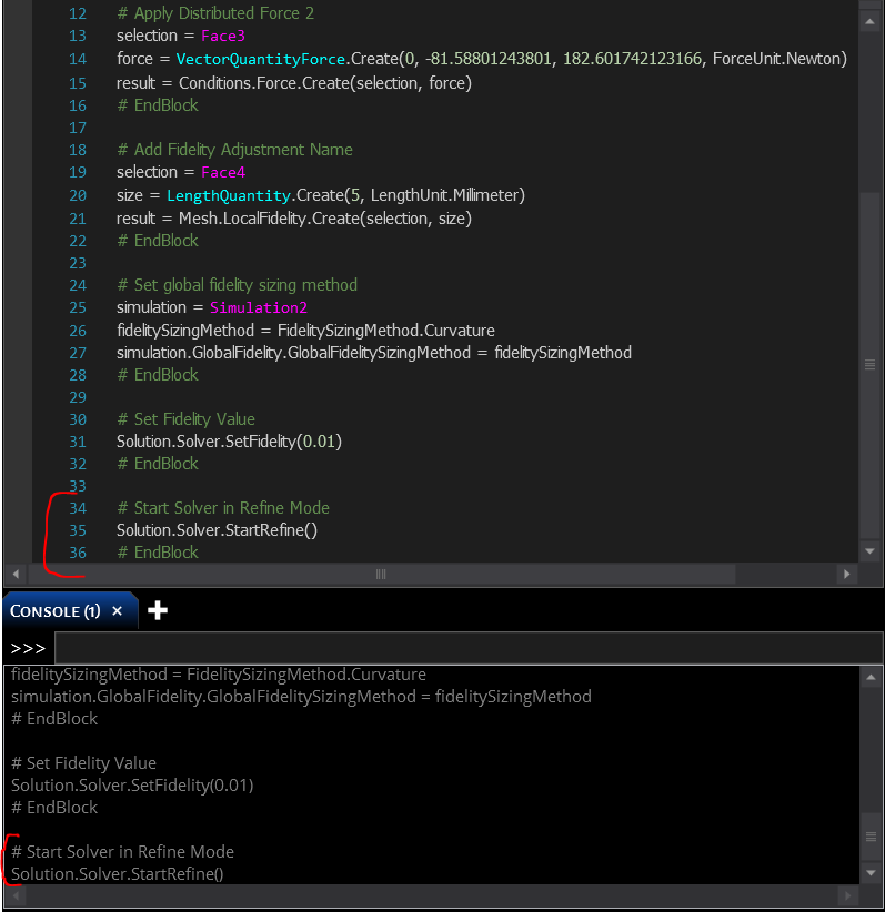

    • Devendra Badgujar
      Hi Karan,
      Are you able to solve in Refine mode without script, this looks problem with solving in refine mode. Can you please try running the bracket sample case in Refine mode and see if that runs.
      I tried the same at my end and was able to run the script:
