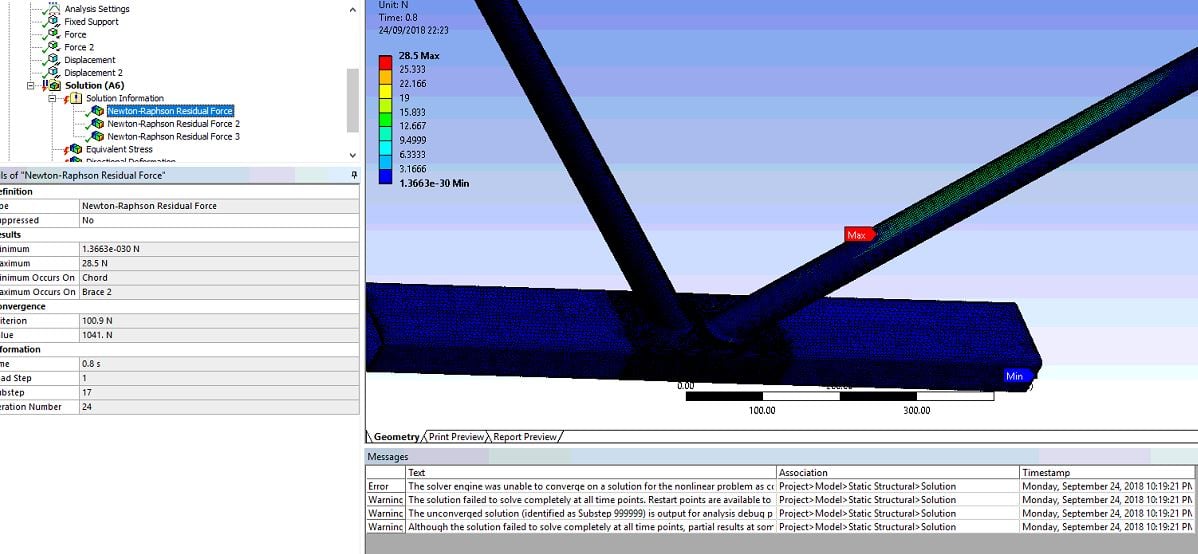

      Hi, I try to modelate this kind of connection , but I have a critical error:
      The solver engine was unable to converge on a solution for the nonlinear problem as constrained.  Please see the Troubleshooting section of the Help System for more information.
      How I can to know which is the error?
      Thanks
      Look at your Newton-Raphson Force Residual plots to see where the solver is having trouble converging. Make smaller/better shaped elements near the area of maximum N-R Force Residual.
      Peter

    • mekafime
      I used Newton-Raphson Residual Force and in the 3 cases, el error is in the diagonal of the connection, but has not another element around.

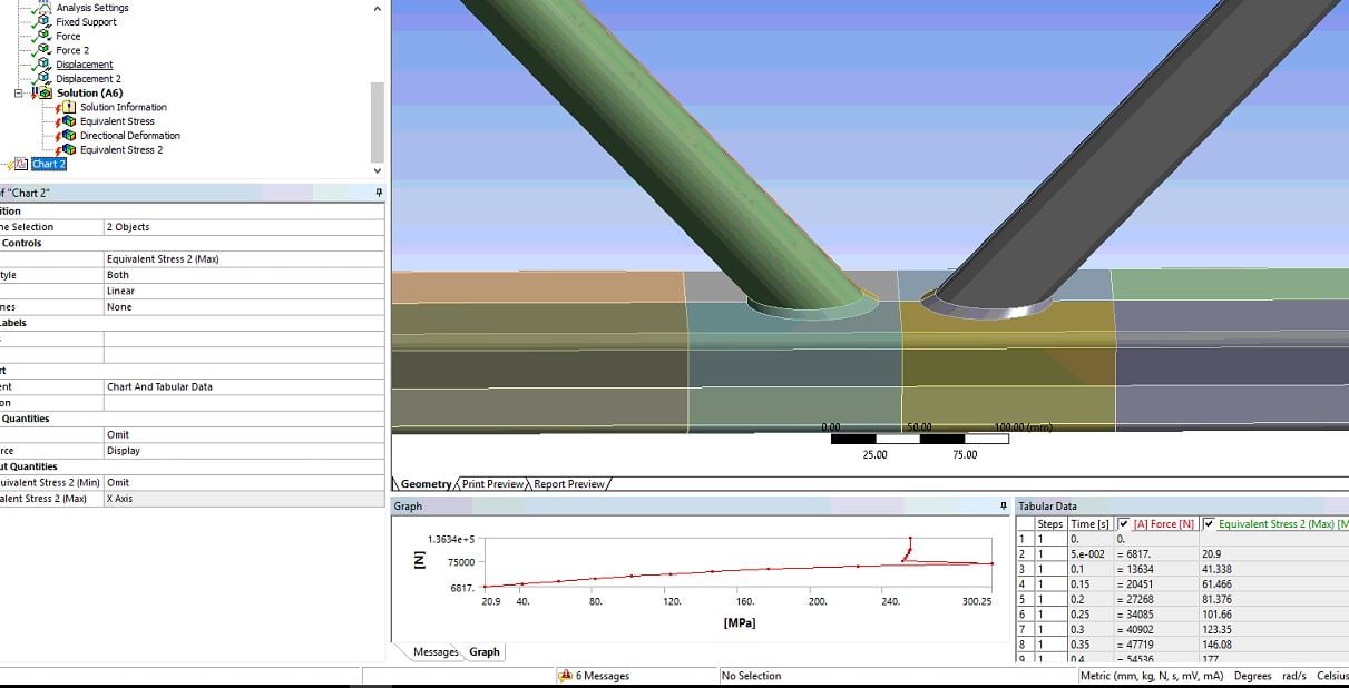

    • mekafime
      Hi
      Analysis no lineal of a connection K-gap rhs and chs.
      Contacts between diagonals and chord is fricctionless and weld with diagonals and chord is bonded.
      Axials forces in each diagonal tension and compression.

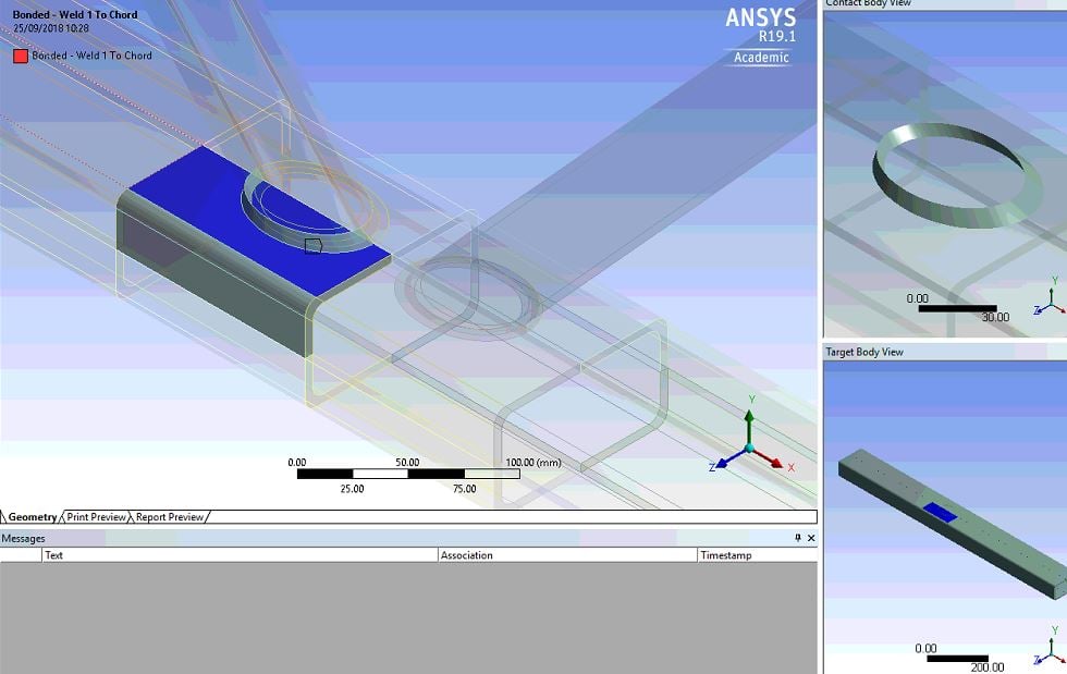

    • mekafime
      No, this is new.
      Frictionless between diagonal and chord.
      Weld between diagonal, bonded.
      Weld between chord, bonded.
      Mesh

      Also, I was referring to the Details of the Contacts?
    • mekafime
      Hi
      I have the same error, I already changed to linear.
      this details?
