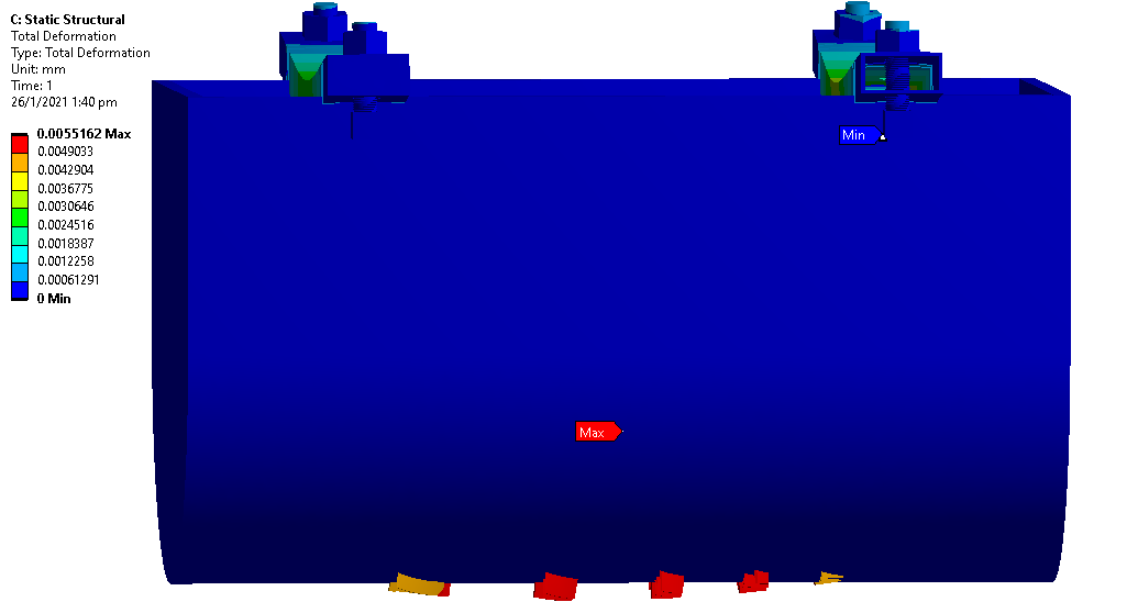

      Dear Experts,
      I performed a static structural analysis of an assembly and the image was the result(deformation). The max. deformation is just 5.5 microns and the clearance (non-deformed) between the tub and the part inside is more than 15 mm. What would be the explanation for the deformation showing the parts projecting out ? Is it just an exaggerated representation ?
    • Aniket Chavan
      What is the results scale that you are using? Try changing it to true scale and see if this happens? https://ansyshelp.ansys.com/account/Secured?returnurl=/Views/Secured/corp/v201/en/wb_sim/ds_Context_Toolbar.htmln-AniketnHow to access Ansys help linksnGuidelines for Posting on Ansys Learning Forumn
    • psansys
      Thank you so much! It was in auto scale.n
