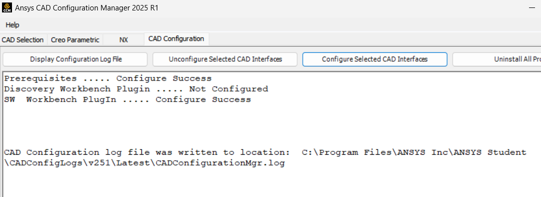

SubscriberAs per title, I've been trying to configure the solidworks plugin in the new Ansys version. For that I executed the CAD configuration manager as an administrator, selected the wished associative interface and received a confirmation of the successful installation.

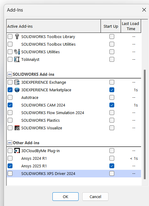

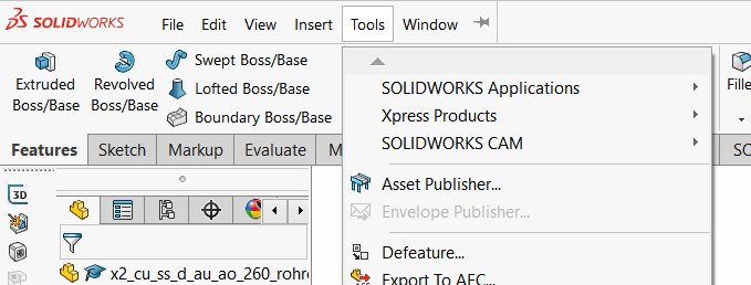

After that I tried to add the add in in solidworks as shown, but it keeps not appearing in the "Tools" bar where it should be.
There should namely be an "ANSYS2025R1" option among the Solidworks plugins. With the 2024 version everything worked fine. I thank y'all in advance for your help!

Can you launch CAD configuration manager as admin and try reconfiguring it again? I hope this helps.Â
Else, Go to 'C:\Program Files\ANSYS Inc\ANSYS Student\v2xx' run Productconfig.exe as adminÂ
Step 1: Unconfigure products and CAD --> select allStep 2: use the same tool to 'Configure' products and CAD --> Select all

giovanni.merlo
SubscriberHello Mrunali,Â
I did as requested but it´s seemingly still not working. The SW interface is marked as configured but it´s not available in Solidworks. I suppose it´s a version-related issue, since it worked perfectly fine in 2024R1 and 2024R2.

dgordon
SubscriberI'm running SW 2022. I can see the 2025 R1 plugin in SW. I click both windows trying to run C:\Program Files\ANSYSInc\v251\aisol\CADIntegration\SOLIDWORKS\winx64\WB251PlugInSWCOM.dll in the SW Add-Ins path. I press OK and still Ansys 2025 R1 doesn't appear in the SW Tools Menu. My admins swear it isn't their security software..... Dave G.
