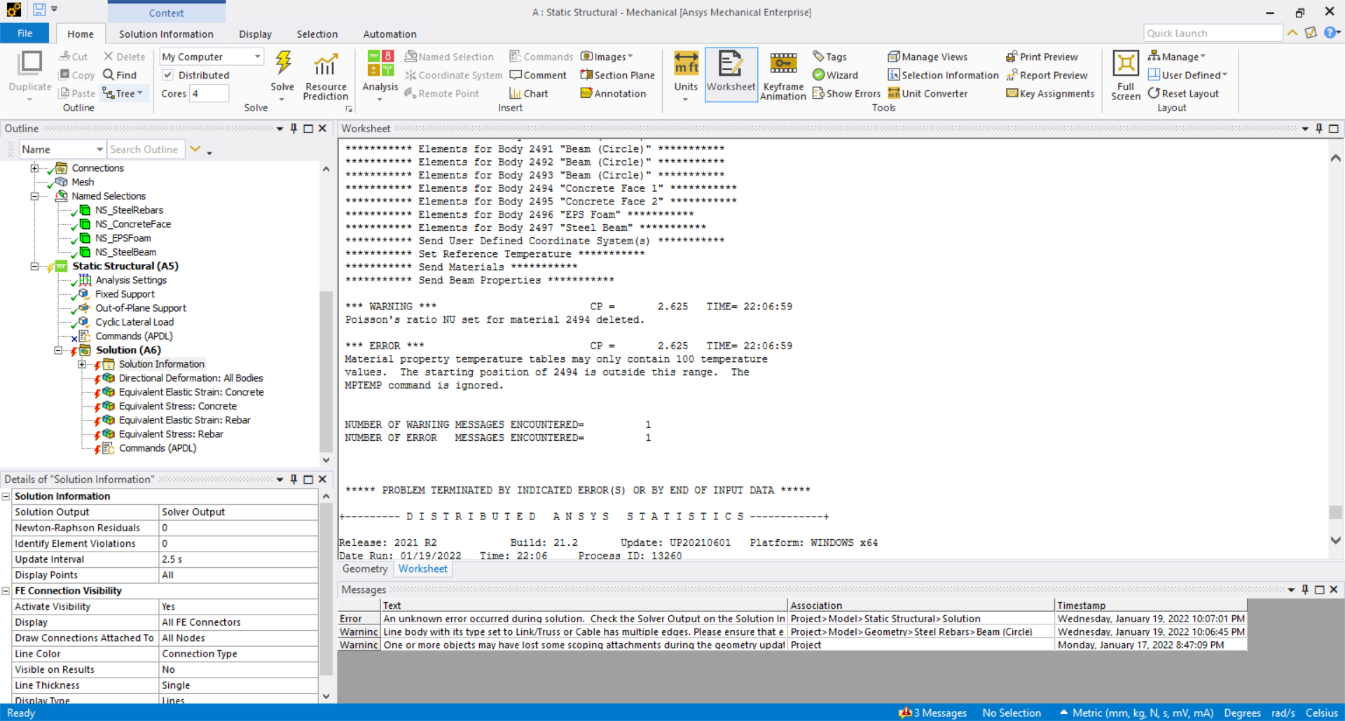

When I tried to run the analysis, the following warning and error messages with regards to the APDL command of my concrete elements are shown. This concerns the Poisson's ratio and Temperature Data.
January 21, 2022 at 5:01 pmDavid Weed
The error message is indicating that one of your MPTEMP commands has a value of '2494' in the SLOC (starting location) field. Note that the MPTEMP command has a limitation of 100 temperatures. I also see that there may be an error in your APDL code where for MPTEMP you are using 'matid' for the SLOC field. In general, if you have more than 100 temperatures, you can use TBTEMP, which does not have the same limitation as MPTEMP.
