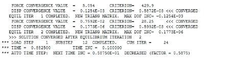

I have a body which is axisymetric, and this body has hyberelastic material. I do not have any convergency problem but I want to use "PLANE 183 elements with KEYOPT(6)=1 which is hybrid element".
When I added command on rubber material there is no difference, I could not understand KEYOPT option was worked or was not work. But when I check solution output, I did not see any convergence value for mixed type elements. I added image.

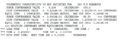

So when I asigned steel instead of rubber like material, I saw volume convergence value for mixed type elements. After that, I can understand KEYOPT(6)=1 is worked. I added image.
So, what should I do? How can I use mixed type elements for axisymetric bodies.

March 21, 2022 at 11:57 ampeteroznewman
SubscriberMy experience was having models that would not converge without the mixed u-P element and would converge with it.
If you have no convergence problem, why do you care if the mixed u-P element formulation was used?

SubscriberAs I know, for rubbery materials, mixed u-p elements better than linear u elements. I want to try and compare results. However, ANSYS is not giving permision for use u-P element with PLANE 183
March 21, 2022 at 12:03 pmpeteroznewman
SubscriberYes it's better when models converge than when they don't.
If by better, you mean more accurate, you can increase the accuracy by performing a mesh refinement study and by reducing the convergence tolerances.
