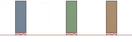

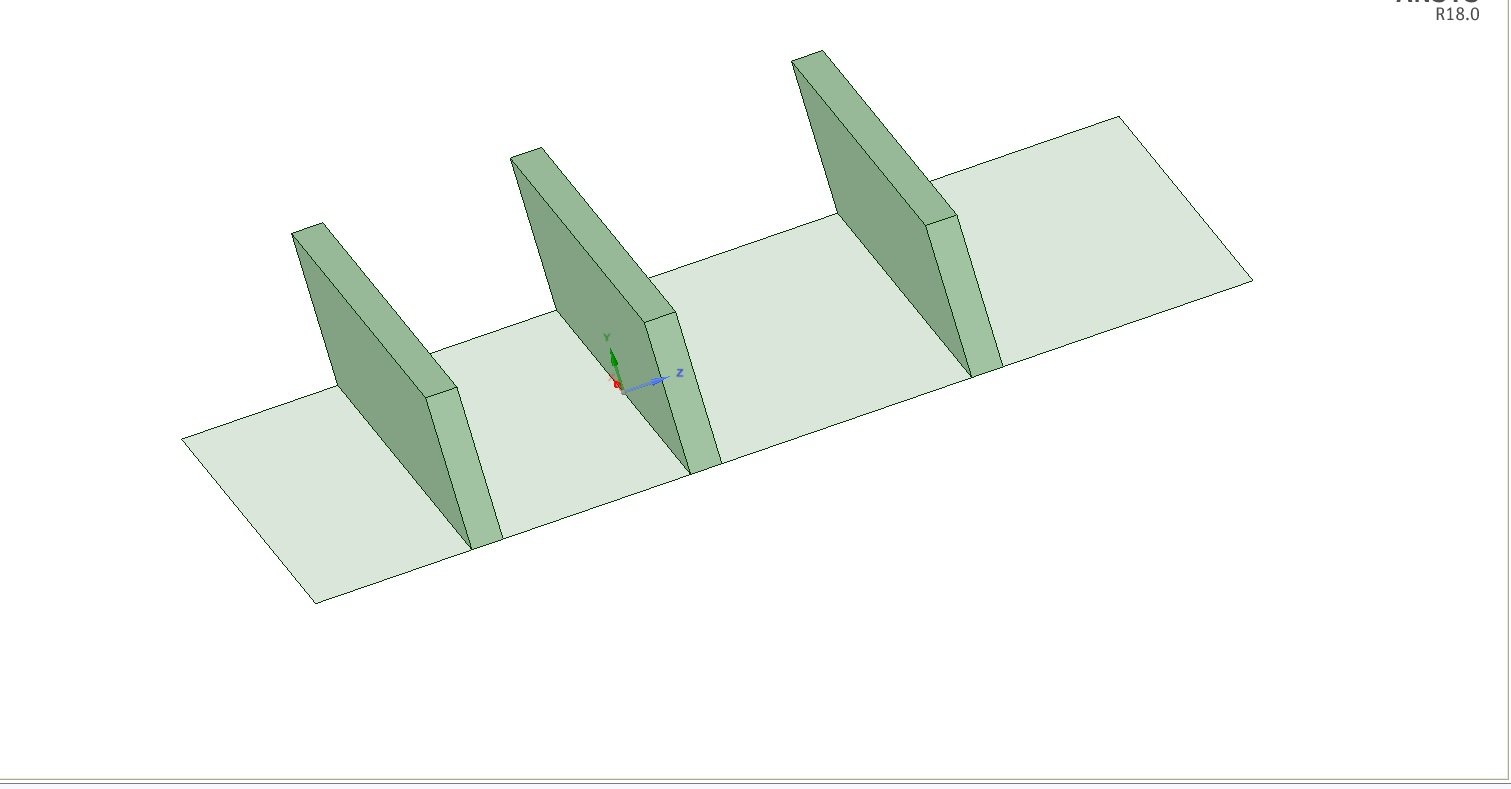

      One way to fix this is to pull the three bridge solids, then create a New Component in SpaceClaim and create the surface body. You also want to select the SYS-1 at the top and Share Topology.

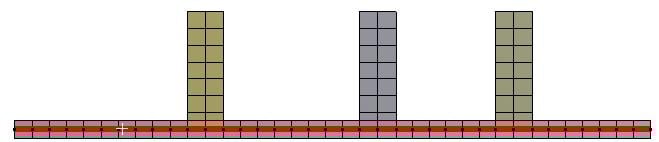

      A best practice is to have a minimum of two elements through the thickness of thin parts meshed with solid elements. Below is the resulting mesh with Thick Shells unchecked.

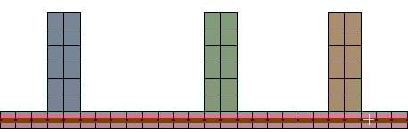

      When you check Thick Shells, it looks like this:
      Note that the bridge solids are connecting with the midsurface of the shell elements. This introduces a very small error, which is negligible for thin shells, but if the shell element is relatively thick, there is another technique that allows the bridge solids to connect at the outer surface of the shell, offset from the midplane. I don't think you need that, but I will show that in the next post for completeness.

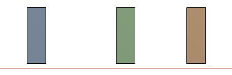

      One small source of error introduced by lengthening the bridges to reach the midplane of the shell elements is the mass that is being added to the model that is not there in the physical model. This could have a slight effect on the modal frequencies.
      One way to eliminate this additional mass is to construct the bridge geometry to the correct height, and leave a gap to the midplane of the shell elements of exactly half the shell thickness.
      When viewed with thick shells, there is no "overlap" of the solid and the shell.
      It is worth splitting the surface body at the tops of each bridge, then adding contact between these faces.
