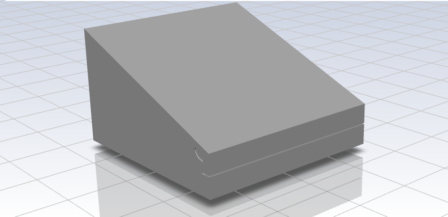

      I am simulating a desalination process using a solar still in Ansys Fluent.
      The solar still uses an initial water level at the bottom, which eventually evaporates and condenses along the sloped glass surface and trickles down into the collector.
      I am using the following settings for the simulation:
      Multiphase model: VOF (Lee model for evaporation-condensation) - air, water, vapour
      Turbulence Model: k-epsilon
      Solar Loading and Rosseland model for radiation
      All the walls, other than the glass and collector, are adiabatic.
      The base heat absorber plate and the glass take part in solar tracing
      Time step size: 30s
      Solutions Methods:
      Pressure Velocity Coupling: Coupled (with volume fractions as well)
      All other fields other than pressure employ second-order upwind with pressure using PRESTO for discretization
      The issue I am facing with this simulation is as follows:
      1. The volume of water collected in the collector after simulating 9 am to 12 pm simulation time is a mere 150 ml (The beginning level of water is 25L with 0.1 vf of vapour in the setup in the beginning)
      Experimentally I require about 3L of water to be collected in the collector
      2. There seems to be an apparent mass imbalance in the plots
      Please help me with resolving this issue. I need to resolve it ASAP.
      Thank you in advance

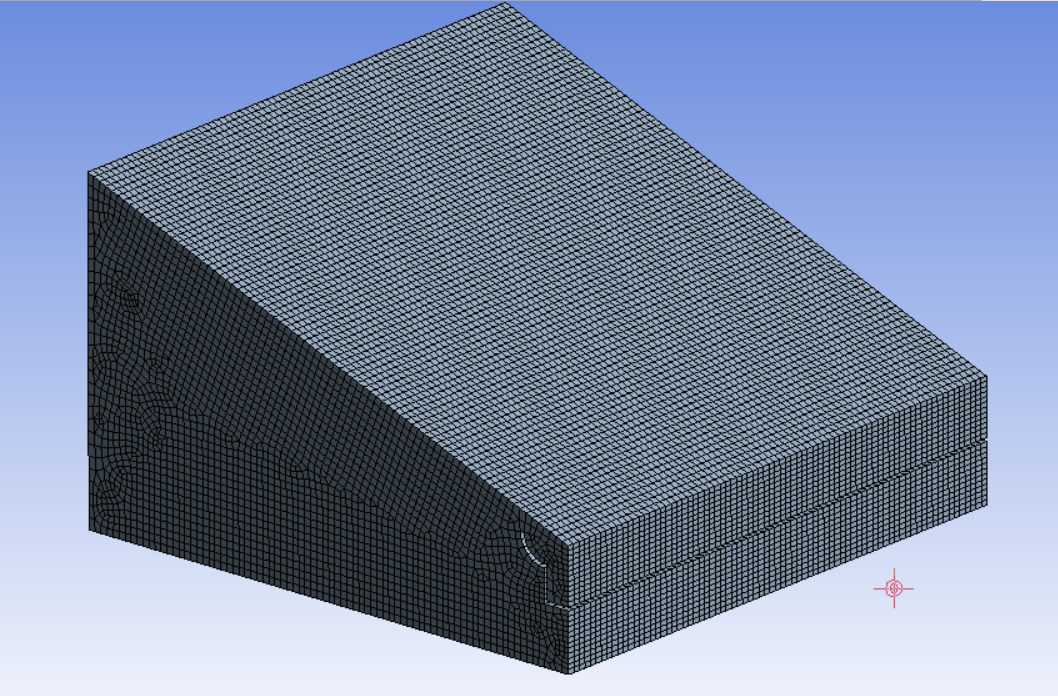

        As for the residuals, the continuity residuals stay constant at about 10^-1 the rest of the residuals are about 10^-3, and energy stays at about 10^-6.
        Mesh statistics for the domain(roughly about 1mx1mx0.6m):
        Nodes: 207168
        Elements: 195965
        Average Skewness: 7.0052e-002
        Average Orthogonal Quality : 0.98508
        Please do suggest changes so that I can start giving them a try.
        Thank you!
      With VOF you need 10-15 cells across the film thickness, and an aspect ratio of fairly close to one to ensure droplets etc are picked up. That's going to get very expensive.
