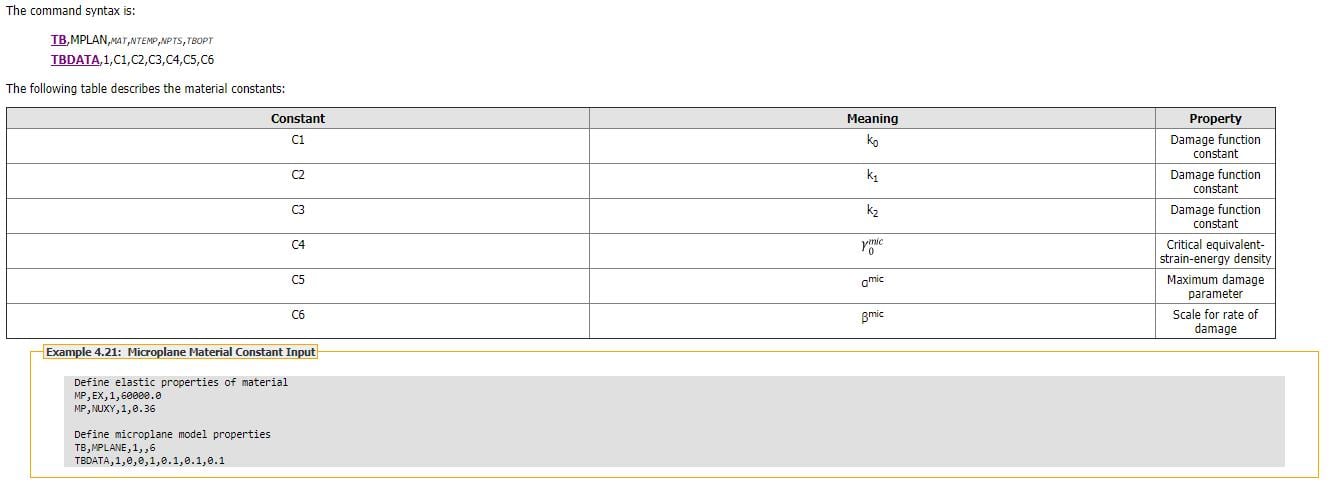

Subscriberhello and greetings to all, I have a question, when I define the Micro plane commands, in that command is the fault criterion already entered? or it is something that I must introduce, because in the literature of that command, they only introduce what Mr. Mirghani,
for example, for my slab model I entered the command:
! Data Element Type
ET, 1, SOLID185
! Data Material Properties
MP, EX, 1,13500
MP, NUXY, 1, 0.2
! Data Input Non Metal Plasticity-Concrete
TB, MPLAN, 1,1,6
TBDATA, 1,0,784,0,784.0.123.5.33e-5,0.7,30
! Data Input Stress-Strain Non Linear - Multilinier Kinematic Hardening (Model Kent-Park Unconfined)
TB, KINH, 1,1,5
TBPT, DEFI, 0.0001.1.35
TBPT, DEFI, 0.0005.6.04
TBPT, DEFI, 0.001.10.35
TBPT, DEFI, 0.0015.12.94
TBPT, DEFI, 0.002.13.8
As you can see, I feel that things are missing, such as stress and compression limits, I also don't know if it is necessary to enter the stress versus strain data.
These are questions that I ask myself because, for example, I used the solid65 with the CONCR model before and there if the effort limits were annexed, while in the microplane no ... thank you very much in advance.
