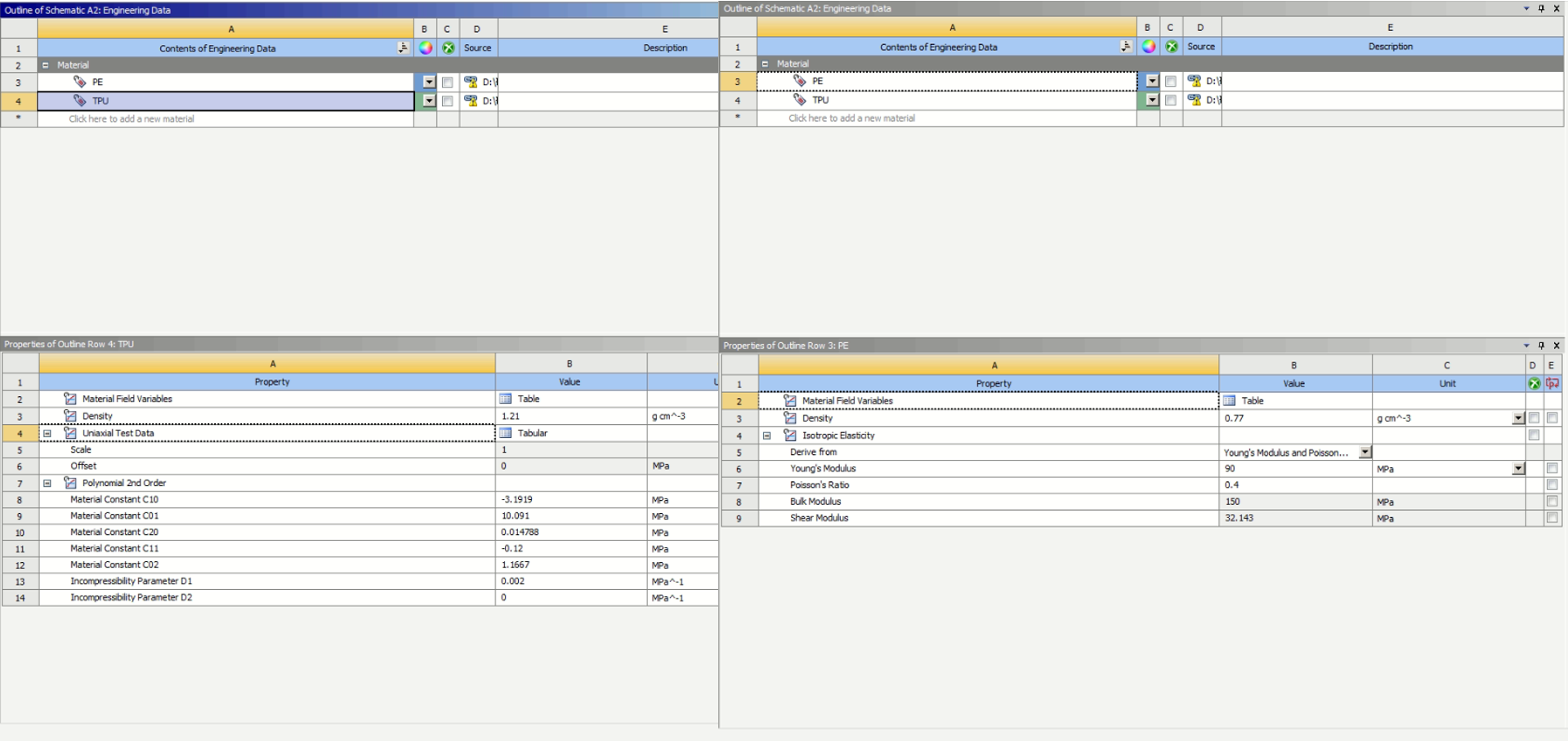

      There are two materials used: PE for the airbag and TPU for the internal skeleton.

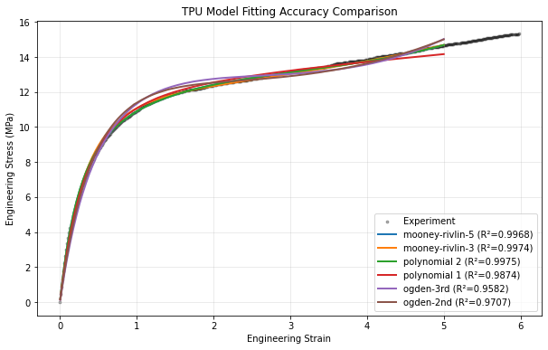

      PE: Density 0.77 g/cm³, Young's modulus 90 MPa, Poisson's ratio 0.4

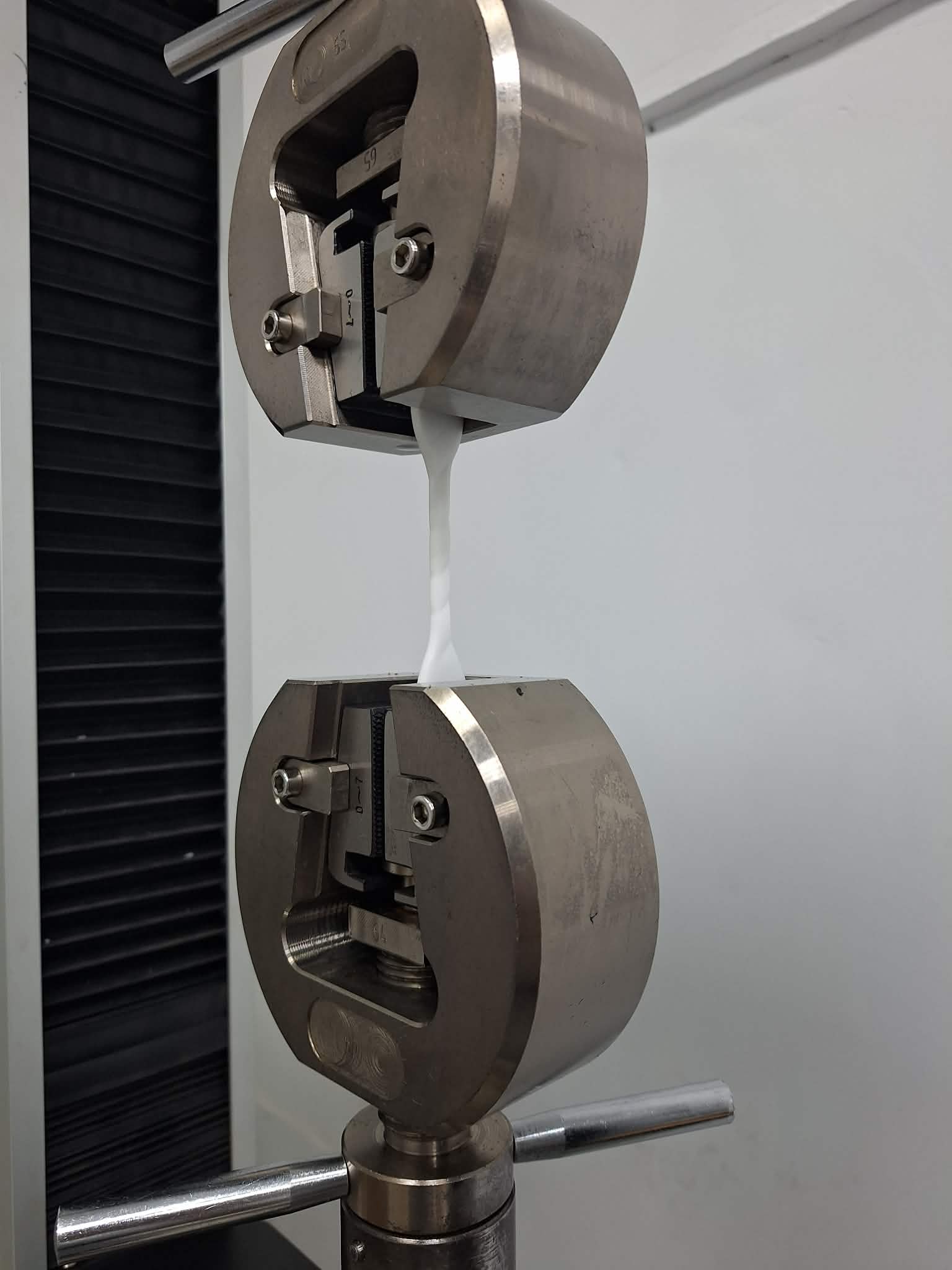

      TPU material was prepared by uniaxial tensile testing according to ISO 37/ASTM D412 standards, followed by stress-strain curve fitting.

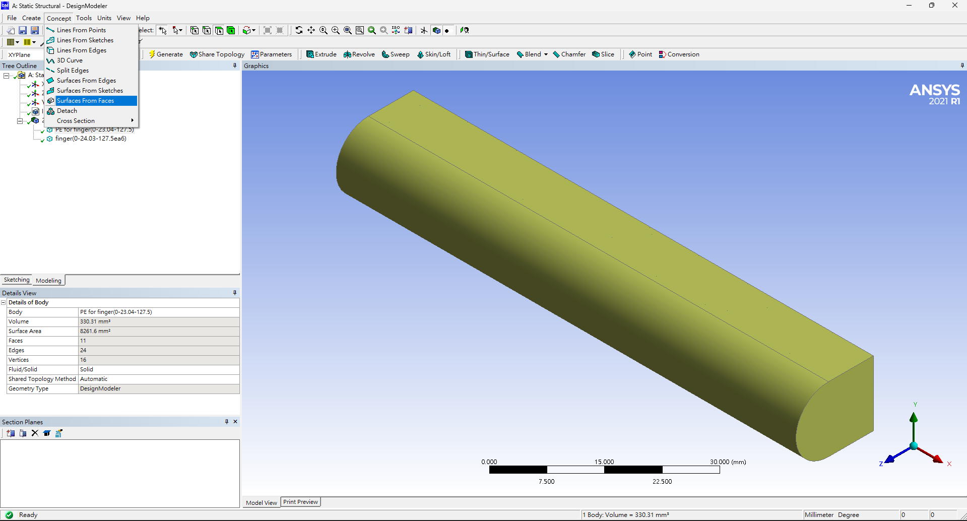

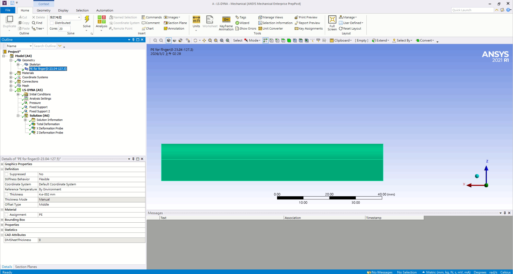

      To improve computational efficiency, I converted the outer PE film into a shell using the surface to shell function in DesignMolder.
    • rian4429
      Step3:
      The film thickness is set to 0.04 mm

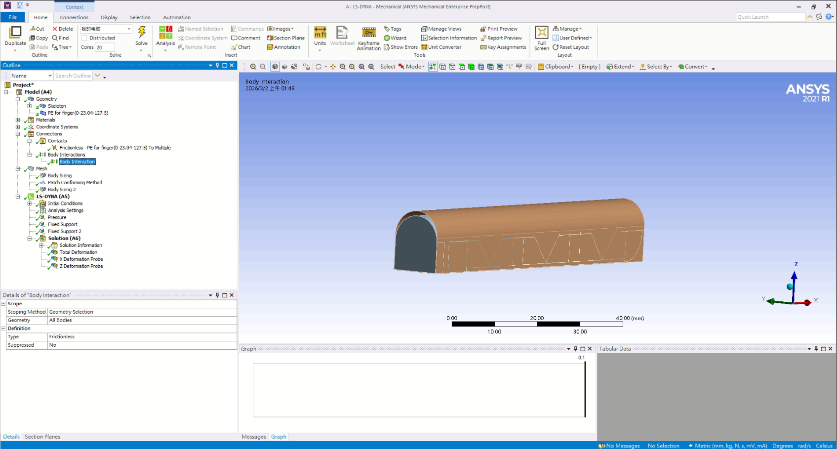

      Step4:

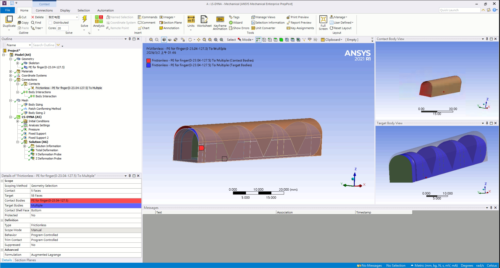

      I defined the inner wall of the membrane as the contact bodies, and all surfaces of the TPU endoskeleton except the bottom as the target bodies.
      Type: Frictionless
      Formulation: Augmented Lanrange
    • rian4429
      Step5:
      Body interaction is also set to be frictionless.

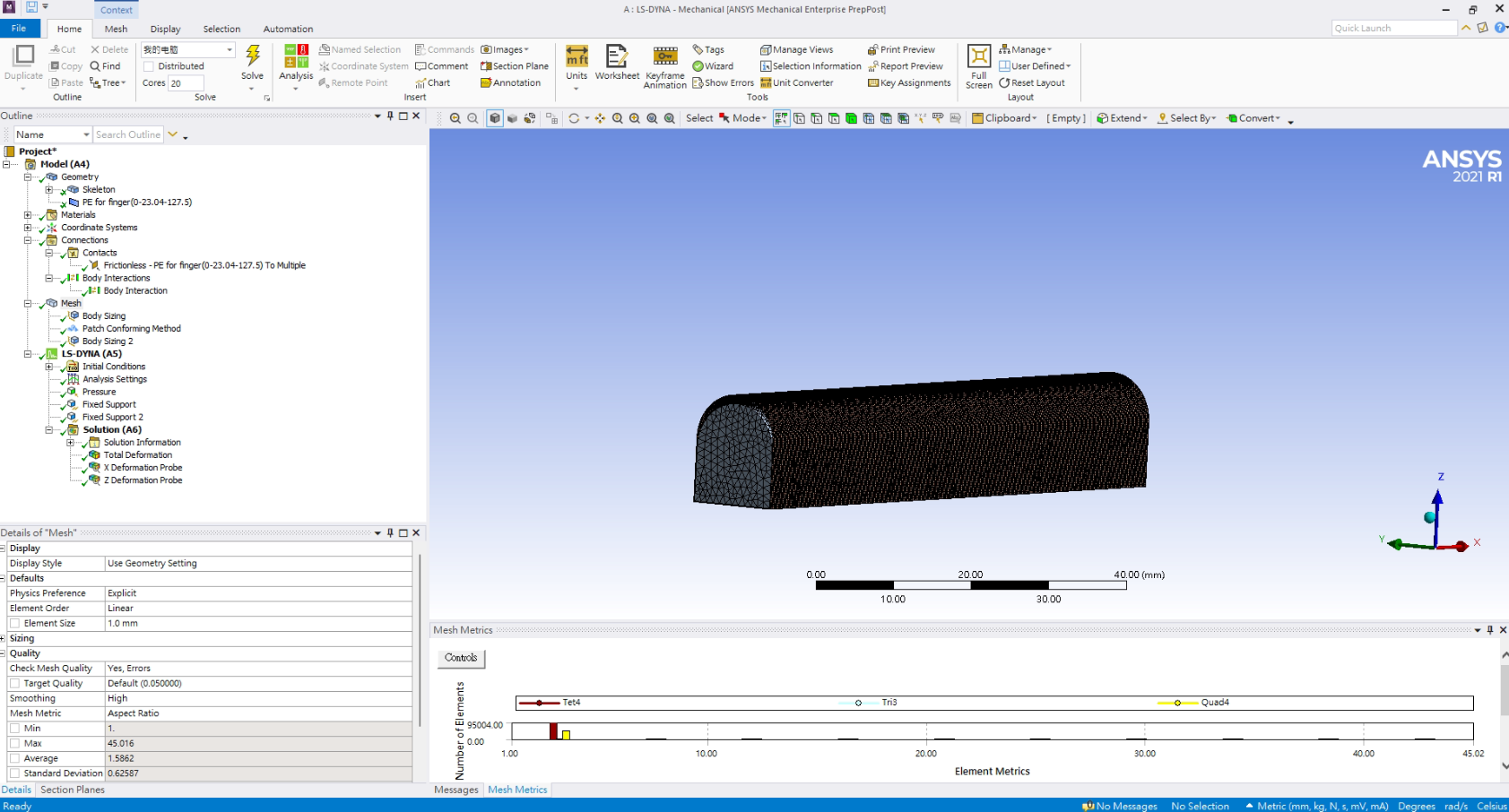

      The element size of the TPU endoskeleton is 1.0 mm.
      The element size of the PE film is 0.3 mm.
      The bottom of the endoskeleton is 0.8 mm.

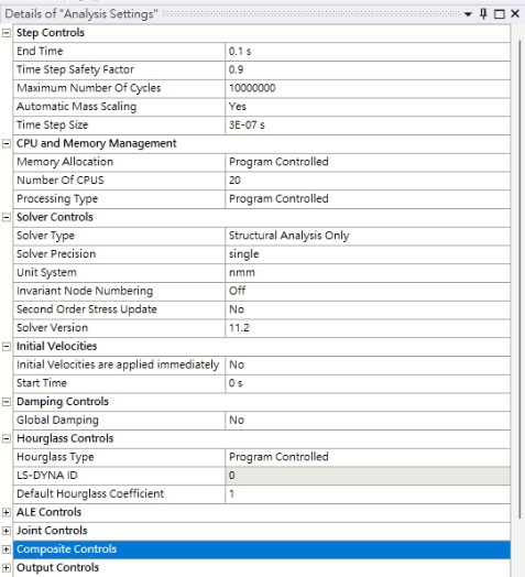

      The analysis settings only adjusted the parts shown in the screenshot.

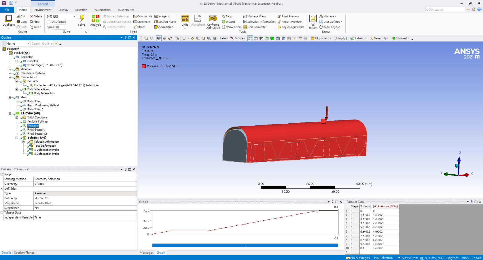

      Step8:
      I couldn't set the film to withstand a pressure of -70 kPa inside, so I changed it to setting the outer surface of the PE film to withstand 70 kPa.

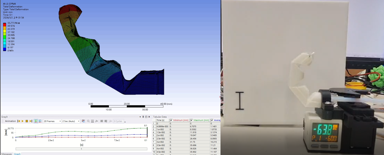

      This image shows the final result of the simulation, with a bending angle of approximately 70 degrees (left image), but the actual bending angle of a flexible finger is 120 degrees (right image).

      The TPU material used in the simulation underwent uniaxial tensile testing according to the ASTM D412 standard, and curve fitting was performed using the hyperelastic model in ANSYS.

      I have reproduced the results from ASTM D412 through static structural simulation and performed curve fitting using different hyperelastic material models.
      Following the procedures outlined in international journals, I calculated the coefficients of determination between the simulation results and experimental data for each model to determine the most suitable hyperelastic material model for this TPU material.
