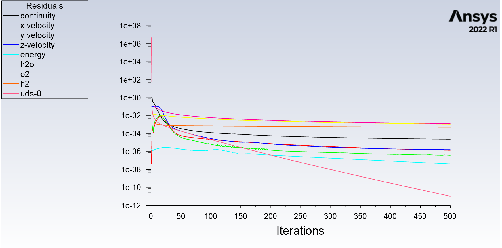

      Hello!

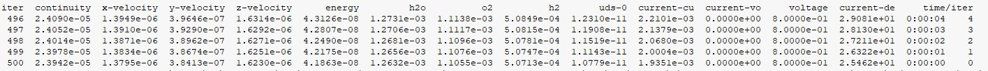

      I am currently working on a study using the SOFC model with unresolved electrolyte. I am getting a very low current. If I lower my applied voltage in the cathode terminal, the calculated reading is also lower which should not. If I increase the number of iterations, it will reach a very low value of about 6e-06 A.
      With this residuals, i think my solution has already converged.
       Given the residual values, I don't think that this is associated with my mesh. All the parameters I'm using are from the literature. Do you have any recommendations on how can I fix this?
      Thank you very much!
    • john.ibrahim
      Make sure you are not underrelaxing the solution.  Also look at the fluxes as this is more important in judging the convergence before looking at the solution.
      Best,
      John
    • Jan Christian Mendoza
      Hello, John!
      I lowered the urf because i'm encountering a floating error at the initial stage of my iterations, and that helped.
      Thank you John for this. I already applied convergence criteria in my residual and in the report definition.
      Thank you!
