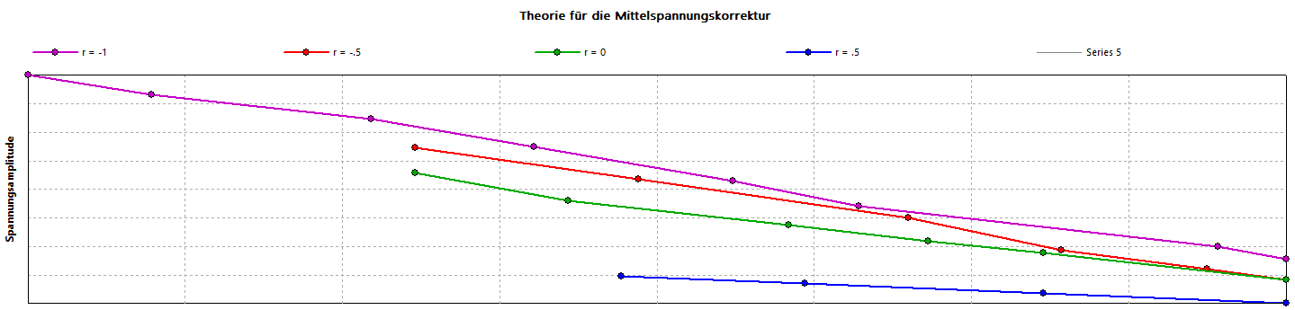

How does Ansys interpret or uses the specified S-N curves? It seems like Ansys is using some type of mean stress correction curves (see image) but not the values I deliberately specified for different mean stresses.

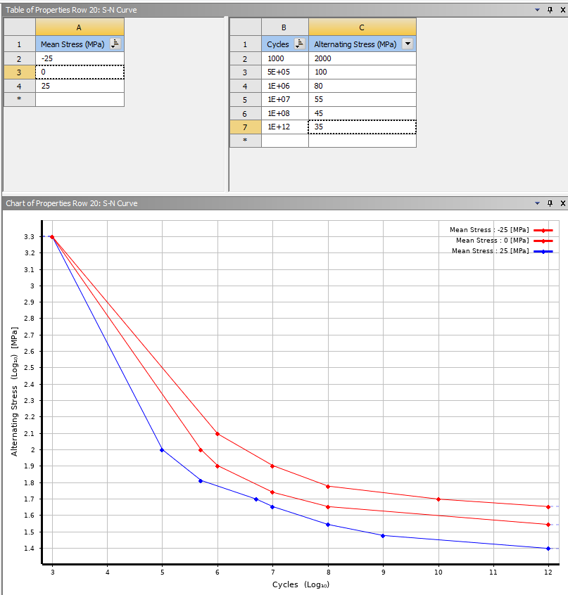

Ansys EmployeeOn an node-by-node bases, the Mechanical Fatigue Tool (FT) calculates the alternating stress and mean stress for the specified loading. If "Mean Stress Curves" is specified as the Mean Stress Theory, the FT uses the S-N curve for that mean stress along with the calculated alternating stress to determine the number of allowable cycles. If the calculated mean stress lies between specified mean stress S-N curves, the FT interpolates between the curves. Â
The mean stress correction curves shown in the FT graphics window are just generic curves shown for visualization. They are not the actual curves used in the analysis. The actual S-N mean stress curves used in the analysis can be viewed in Engineering Data.
Why do you have a S-N curve with a large negative mean stress? The effect of negative mean stress is usually ignored. Can you show an image from Engineering Data of your curves

SubscriberFirst of all, thanks for your reply! To be honest, I think I solved my problem. But let me explain in detail, hopefully this helps others as well:
First, concerning the Question: "Why do you have a S-N curve with a large negative mean stress?":
If I have a part that is cyclically loaded in a zero-based manner, that means the load is applied and relieved periodically, but never inversed, some regions may see only compressive stresses (an no tensile stresses ever). A lot of material models assume higher fatigue loads for such compressive forces (which intuitively makes sense to me). And in order to consider that fact, I do need S-N-curves with negative mean stress values (since the compressively loaded area has a negative mean stress). Otherwise, the calculated safety factor is too low for such areas.
Concerning "The mean stress correction curves shown in the FT graphics window are just generic curves shown for visualization."
Good to know! Just a bit confusing that they show these (meaningless) curves...
Now concerning "There appears to be a bug when using a mean stress curve with a negative mean stress."
That was my first thought: A bug. But I guess the details are very crucial! In order to consider the S-N curve with negative mean stress, I have to assess the ABSOLUTE first principal stress (or absolute von-mises stresses). Because in the compression area, the first principal stress is not relevant but the third one. The one with compressive stress. By choosing ABSOLUTE first mean stress, I assume Ansys takes the first mean stress with the highest number, independent from the sign (+ or -). And then I get a safety factor of 1 for the compression side as well (in my test model described!
Now I hope I'm not just thinking I understood everything... ?
