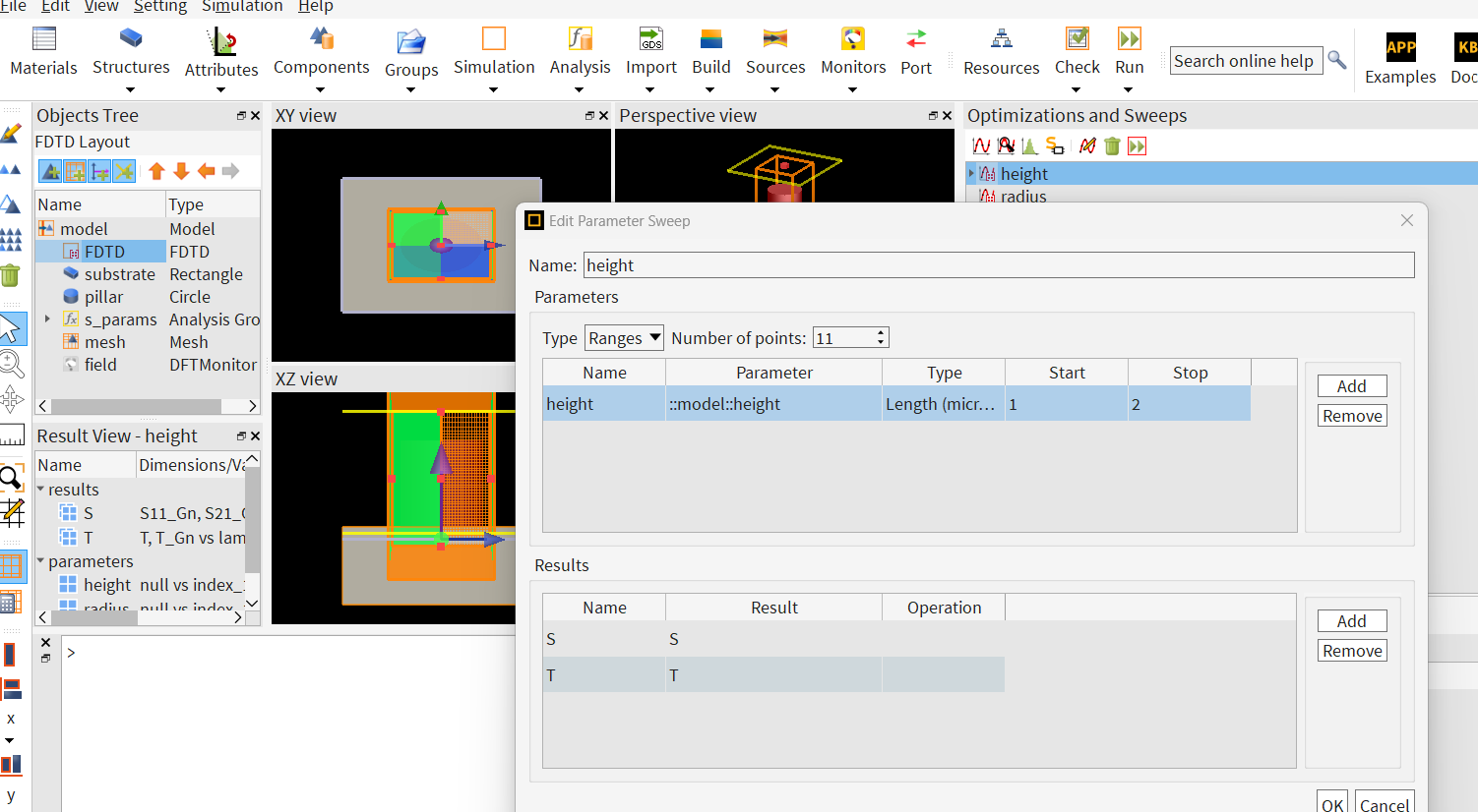

      Second, I noticed that the "unit_cell_fdtd.fsp" file has optimization/sweep variables called "height" and "radius". When I try to edit these sweep variables and try to run "unit_cell_fdtd.lsf", the sweep variables will reset to what they were before. Where can I edit this so that I can change the height and radii of the sweep?

      2: "When I try to edit these sweep variables and try to run "unit_cell_fdtd.lsf", the sweep variables will reset to what they were before"
      Did you click "ok" or better "apply"?  I modified and clicked "ok", it works fine:
      Please install the latest version and see if it works.
