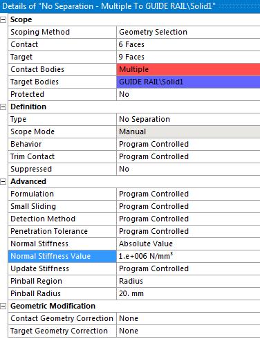

      In the pictures above , The no separation connection may be not be visible but it follows the same problem, when i put the Normal stiffness values in these yellow boxes they dont remain there they turn back to zero when i update initial information . both for friction and for the no separation . I have even changed the parameters from program controlled to manual nothing happens it just tells me to give an normal stiffness factor which i dont know how to relate to normal stiffness of 600000000N/m.

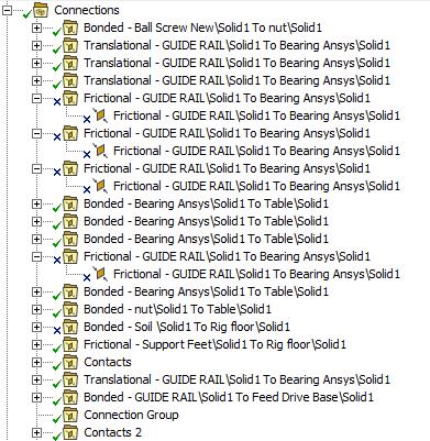

      I recommend you delete all the Frictional - GUIDE RAIL contacts because they interfere with the Translational - GUIDE RAIL joints that do what you want.
    • AbdulBasit03
      I have supressed them , but i am still unable to update the normal stiffness value of the no separation contact in the contact tool , it doesnt change . Did try changing the normal stiffness ? it always remains at 1.9074 e+014
      I also recommend you delete all the Translational Joints as well because they interfere with the No Separation contacts (which I didn't see before).
      I recommend you merge the two No Separation contacts on the same rail into one contact with two carriages and flip the Contact/Target scope.
      You can override the Normal Stiffness Value, but I don't recommend it.

      Look at the Normal Stiffness Value, it has units of N/mm^3.  You have a stiffness with units of N/m.  You would need to know the area of the contact that ANSYS is using in order to convert the stiffness you have to the stiffness you have to enter into ANSYS.
      Once you see how mode 1 and mode 2 moves, you will see that the stiffness of the bearings will have no practical effect on the frequency or mode shape of modes 1 and 2.
      Modal analysis uses only frictionless No Separation contact. It cannot include friction because it is a Linear analysis.
