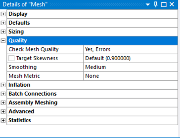

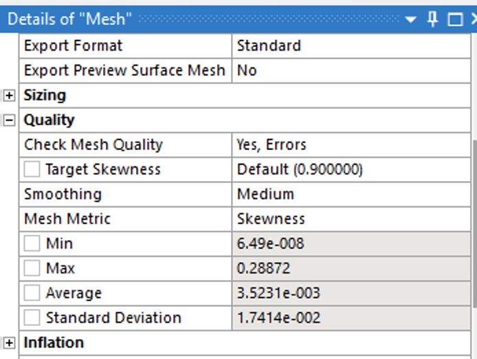

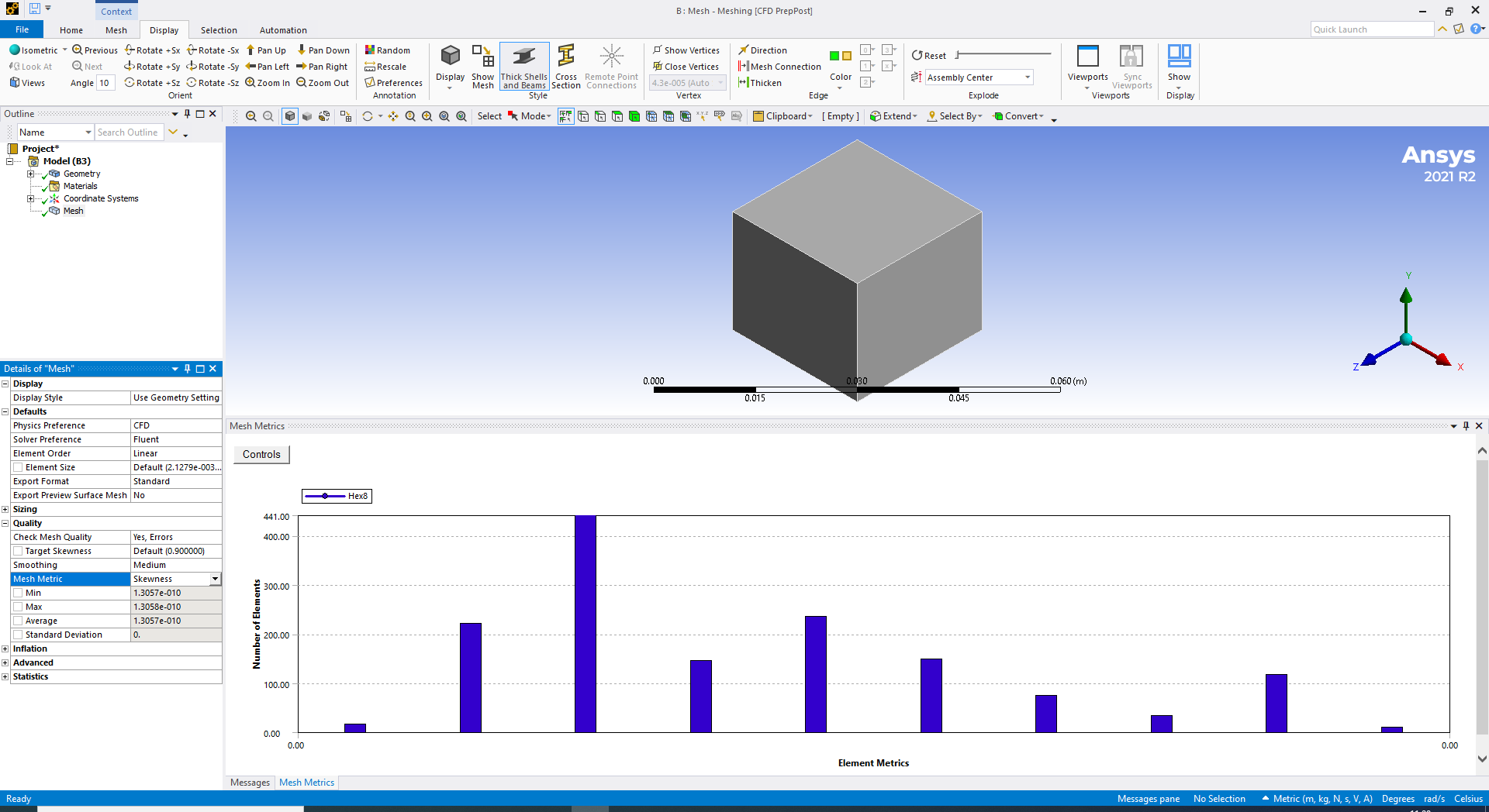

Subscriberwhere can I find skewness of mesh for Ansys Fluent?
August 23, 2021 at 5:37 pmDrAmine
Ansys EmployeeMesh check. You can increase mesh check verbosity to increase the output printed in the console.
August 23, 2021 at 5:38 pmDrAmine
Ansys EmployeeSkewnes is standard metrics under Quality.
August 23, 2021 at 6:51 pmAugust 24, 2021 at 10:04 amAugust 24, 2021 at 11:22 amDrAmine
Ansys EmployeeAnd you need to do that again inside Fluent but since a couple of releases I am seeing that the values are printed are consistent but again I will more rely on the values printed by Fluent as you want to solve in Fluent.
August 24, 2021 at 2:46 pmAugust 24, 2021 at 3:40 pmRob
Forum ModeratorGiven skew is bad over about 0.9 I'd not worry in this case. There are some functions in Fluent that can improve the mesh, but they're not generally used now: they're from the "good old days" when the meshing tools weren't as reliable.
