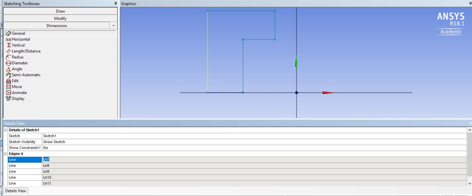

      I would like to ask you a question on the way I can define the dimensions in the Design Modeller sketching from the menu on the bottom left, below the sketching toolbox, in Details View.
      I have attached the image of the sketch of a model that I am trying to dimension, however when I go to the relevant menu and the respective line that I want to give dimension, as the tutorials suggest, there is no option for that, and I cannot give any value in the respective blank (Image attached). Any suggestions?
      I am not sure whether the version of the software play a role but I have installed in my laptop Ansys 18.1.

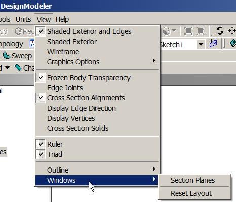

      Go to View and look through the options for Windows(?) or Toolbars and there's a reset layout. I think you've moved something by accident and the dimensions box is underneath the Details View panel.

      Use View, Windows, Reset Layout.

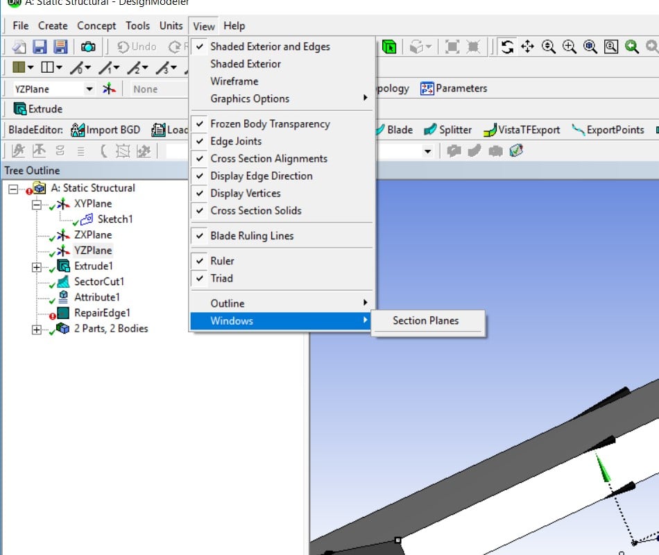

      In my View menu, at Windows does not appeared this option of `Reset Layout `(Image attached). I will try again.
      Kind regards,
      FX
      Reset Layout does not appeared
