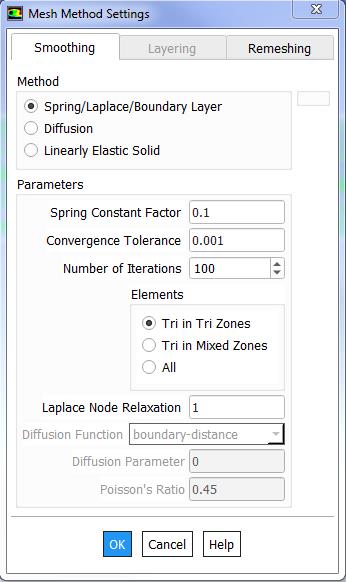

      can you please give details related to right wall only like dynamic mesh zone, mesh info, smoothing and remeshing parameters.
    • Max4

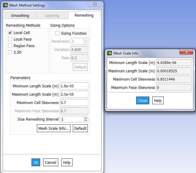

      The dynamic mesh parameter are as follow. The mesh is made with tet cells with size of 2E-5m. Moreover, the geometry is composed of different zones, where the size of the mesh is different, where the values of Mesh Scale Info come from.

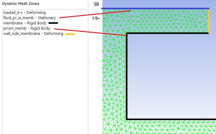

      The moving boundary wall is set as Deforming (Smoothing + Remeshing). The part "bauteil_4-v" represent the interior mesh and is set as Deforming (Smoothing + Remeshing). Inflation layer "fluid_pr_w_memb" and "membrane" are set as Stationary respectively as Rigid Body.
      I have tried with other min. max length scale but it does not solve the problem. I have tried with Region Face too, but it affects negatively the rest of the domain, while the remeshing along the boundary moving layer is better.

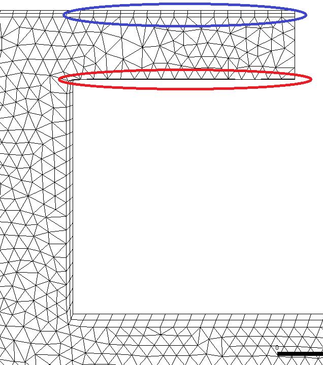

      can you please try using 'deform adjacent boundary layer with zone' for rigid body.

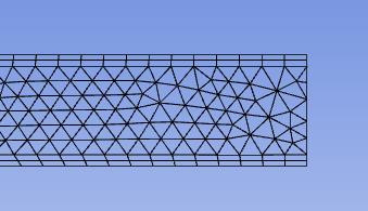

      also try one more - do not set any condition for interior.
    • Max4
      By using "deform adjacent boundary layer with zone" for the rigid body "membrane", I obtain negative cells. Inflation layer on the top (blue) are stretched while the cells below (red) are compressed.
      If I set any condition for interior, I get the following. Cells along the moving boundary layer are too stretched and big.
