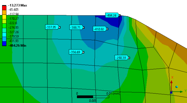

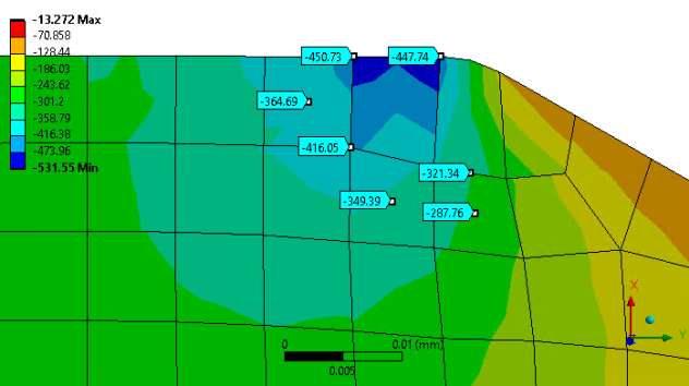

      I am facing some trouble with result evaluation in areas (corner of press-fit) that show clear singularity effects. Decreasing mesh size leads to increased stress focused on just one node if looking at nodal stresses (average). Now the question is, if it is good practice to evaluate stresses by looking at elemental stress instead of nodal results?

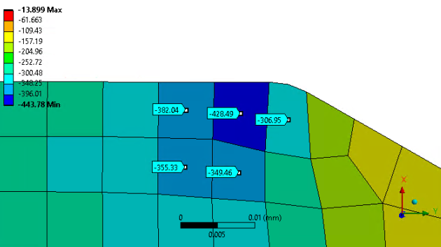

      As I would like to automate the post-processing, I would like to extract the max/min values but in case of a stress concentration/singularity, I am forced to check the model manually. Using elemental results would probably help as it kind of average out the peaks. But is still a feasible approach?
      Generally, we are looking at max./min. principal stress due to the material behaviour and not equivalents if that is of any importance.

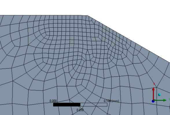

      Mesh size (0.0075 mm)
      Nodal results (averaged)
      Nodal results (unaveraged)
      Elemental results

      my two cents: in my opinion even looking at the stresses in the elements you can't avoid stress concentrations. If you shrink the mesh even the stresses in the elements (which, by the way, are the ones that are calculated first, at the Gauss points, from the nodal deformations, which are the real "solution" of the FEM system of equation: then they are extrapolated to the nodes), they too will grow indefinitely.
      If the real stress state at that location is important to you (i.e., you can't do your maximization excluding that location), I personally see no alternative but to use a material model that is a little more realistic than linear: at a minimum, bilinear. That way the peaks will eliminate themselves, as they do in physical reality, generating microzones of plasticity.

      Thanks for your reply. Make sense that with indefinitely small element, also my element stress will diverge. However, I have done many different simulations of press fits and it seems like we get "smoother" results if we look at elemental stress which makes it possilbe to kind of automate post-processing. And if I get you right, elemental stresses are somewhat closer to reality as they are calculated directly from Gauss points.
      For the non-linear material, I will have a look at.
    • Claudio Pedrazzi
      I simply say that they are a more "basic" result of FEM.  I try to formulate better:
      In my understanding (but some ANSYS people could confirm this) the sequence of computation for a standard linear FEM based on K*u = F system of equation, where K= stiffness matrix, u=unknown nodal displacements, F= "forces", is the following:
      1. First solve for u (nodal "displacements"). These are the real "unknowns" in the FEM-method.
      2. based on each element formulation, find the stress in the Gauss (integration) points in the elements. They are univoque (unique, unanbiguous).
      3. optionally extrapolate the stress to the nodes (see ERESX). Since generally one node can belong to more than one element, they are not univoque, i.e. there is one stress for a given node for each element connected to it.  Hence the optional extrapolation, the averaging and so on.
