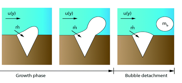

      has anyone already had experience with fluent multiphase simulation of the growth of a single bubble until detachement in an oversatured water flow. Problem is considered 2D. See Picture describing the problem (© picture taken from this Paper DOI: 10.1039/C9LC00211A)

      Have a look in the multiphase sections of the User’s and Theory Manuals. In answer to the questions, yes we can, but it’s not necessarily easy.
      Edit: DNS can be used to solve the problem, let us know how you get on writing the core numerics, solver and models!
