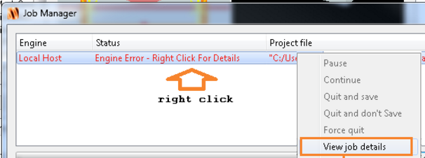

      When this happens, check each of the "sweep's_p#.log files" for any errors.
      Is there any error message from the job manager when running the sweeps?

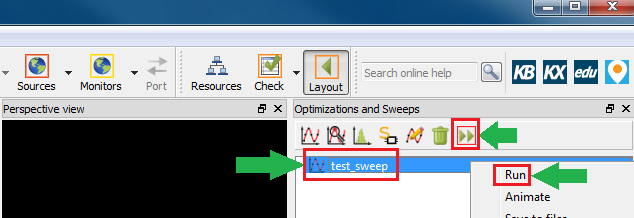

      Try to run your parameter sweeps outside of your script. -- i.e. using the "Run Sweep" button on the CAD/GUI. Then check if you have all the data/results on the sweeps. This should confirm if the issue is when running the sweeps on something on the script/scripting environment.

      Did you try to run your sweep from the CAD/GUI as per my previous message/image?
      Can you try to run this example sweep from our Application Gallery? https://support.lumerical.com/hc/en-us/articles/360034922873-Parameter-sweep-utility . Run the sweep from the CAD/GUI as shown in the image.
      If the issue only happens to your simulation/sweeps, please check if the simulation/sweep files are not corrupted/damaged. Try to remove the previous sweep's files from the sweep's folder and rerun your sweeps. Otherwise, if the sweeps run without any issues when run directly from CAD/GUI, there could be something wrong with your script.
