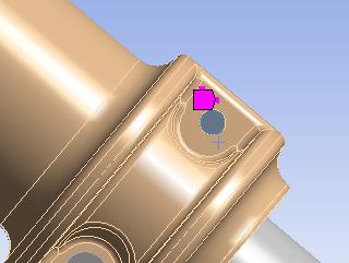

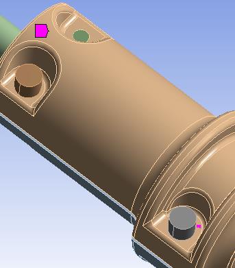

My simulation won't even start. And Solver output isn't much help.
Please someone tell me what's happening!
Here aer some snippets from the Solver Output:
*** ERROR *** CP = 153.219 TIME= 14:44:57
The preconditioned conjugate gradient solver failed with an error code
of 1. Please check for an insufficiently constrained model.
Switching to the sparse direct solver may allow this nonlinear
analysis to continue beyond this point.
*** NOTE *** CP = 35.625 TIME= 14:43:13
Max. Initial penetration 0 was detected between contact element 112650
and target element 112721.
Max. Initial penetration 0.475991245 was detected between contact
element 112178 and target element 111687.
