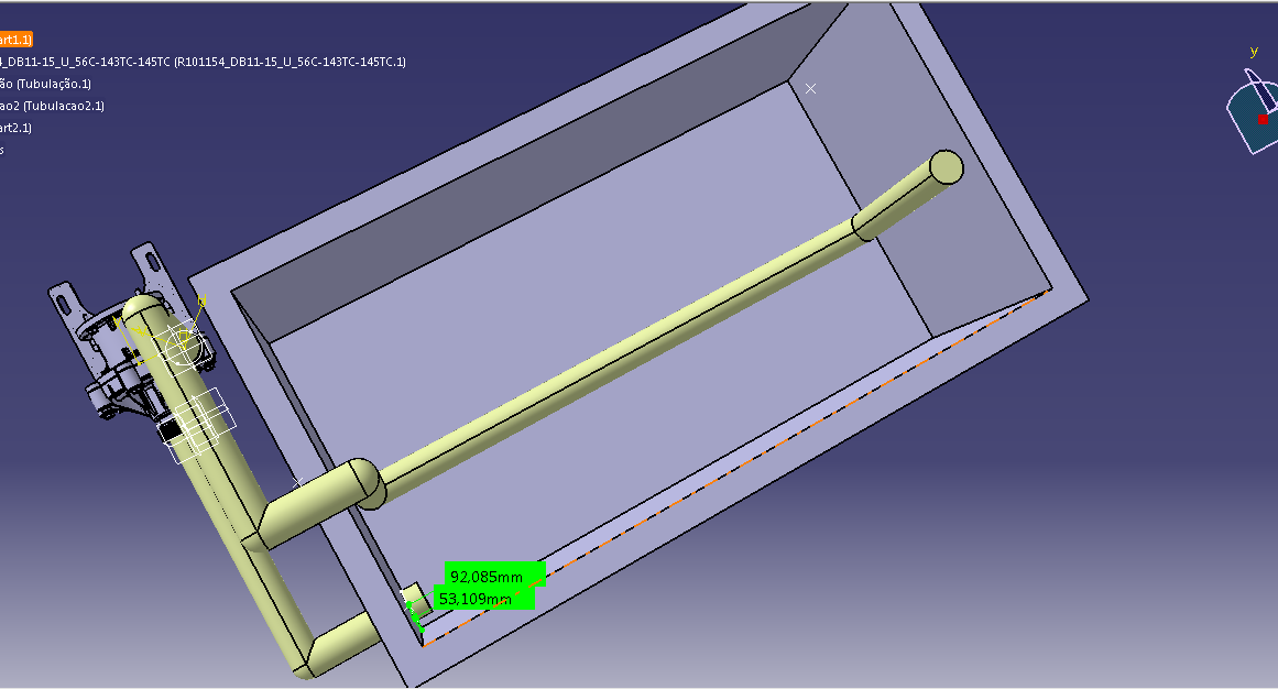

Can i use Ansys software to simulate a real case. I mean, i need to simulate a hydraulic system like the picture and see if the pump can evade the water with a good flow rate. And also, see the water agitation inside the tank.
*In the picture we can not see the eductors nozzle in the vertical pipe, but is there the place where i will install this nozzles.
** I need to improve the water agitation at center of the tank. Currently the nozzle is at the bottom of the tank and do not produce the flow rate necessary to shake the water as i need (it is just one nozzle). So, that because i'm planning to put nozzle in the vertical part of the pipe(2 nozzles).
So, basically can i just input the pump caracteristics and draw this system and see the tank filling with water? and also see the tank agitation?
The main question is calculate if the pump can evade water by 2 differents holes. Because i need flow rate in boths vertical wall to have a good agitation at center of tank.
*** There is a pump but is just visual draw.

Forum ModeratorThe CFD solvers will predict flow patterns based on the set boundary conditions. I'm not quite sure what you're asking, but assume "evade" is a mistranslation for "escape", by which you mean removing the water.
