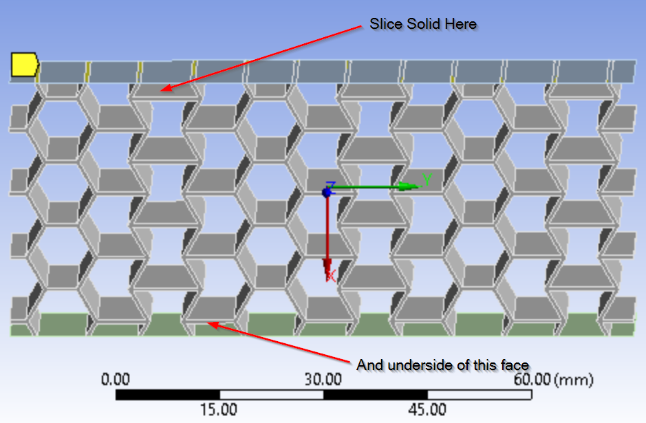

I'm Lidianne, graduate student from Brazil. I need help in simulation of honeycomb structure in static structural. Can you help me, please? The software don't accept solve the model, that is in the figure:Â
June 22, 2021 at 1:18 ampeteroznewman
SubscriberDear Lidianne I suggest you slice the solid geometry on the horizontal flat face to have a larger surface area. Also, you can try eliminating the rigid surfaces, holding the bottom faces Fixed and applying the Ux Displacement on the top faces. That should allow it to solve.
Also, try meshing so there are 4 elements through the thickness as shown in this video.

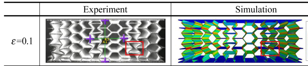

The model for the article is this. They used shell elements in the model and so did I.

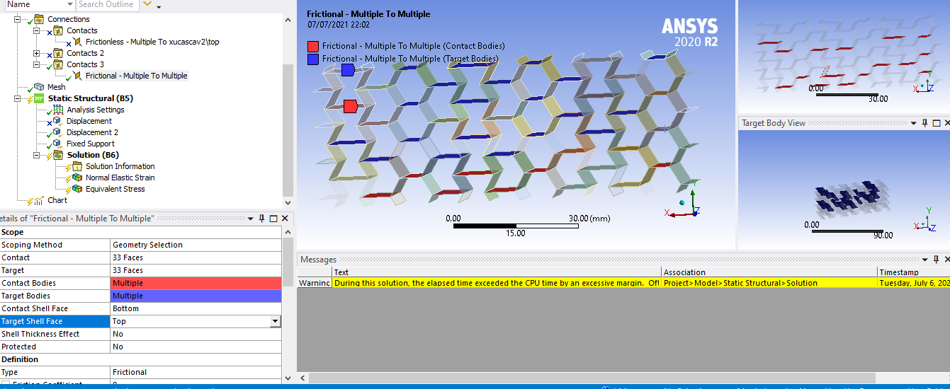

I'm having trouble generating self-contact. Is this correct? Some surfaces are selected at the top and others in the bottom. I couldn't keep a correct order. I also needed to select the same surfaces in target and contact of self-contact.
Attached is the my project. Please consider only "A" and "B" of the project.

SubscriberI downloaded your .rar file, but you put in the .wbpj file which is not useful on its own, it needs the _files folder of the same name. If you open the .wbpj file in Workbench, use the File Archive menu to save a .wbpz file. That is an achive that has all the information needed to open on another computer. Please attach the .wbpz file to your reply.
Did you download my file in this discussion? /forum/discussion/2522/defining-self-contact-in-static-structural/ It is the third post in the thread and has a .wbpz file that you can open. The correct procedure to setup contact for Static Structural is tricky. It would be easier to show you in a video meeting.
