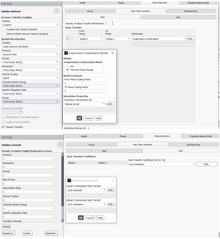

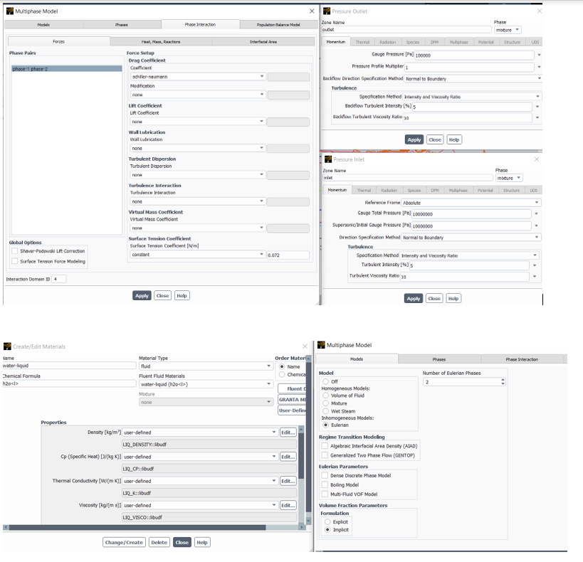

I am trying to simulate flashing flow conditions in a pipe. It is a 2-D simulation. Till now, I have used Mixture Model>Evaporation-condensation Model>Lee Model (with UDF for Saturation Temeprature and Eulerian Model>Evaporation-Condensation Model>Lee Model (along with UDF for saturation Temperature). The convergence for both of these cases are good with quite low residuals but, I am not getting chocked flow/flashing conditions i.e. the velocity of the vapour phase is not reaching mach conditions as we expect them to. I am using pressure inlet with 100 bars inlets pressure and 583.15 K Temperature and 1 bar at the outlet with backflow temperature set at 500 K. Moreover, I am using UDFs for both water and vapour materials property ranging from 275 K till 635 K saturation conditions.
What can I do so that I can have choked/flashing in the pipe and the velocities reach higher values. I am using SST k-omega model right now. Can someone give me some advice. I can post the images of the simulation set-up if required.Â
Currently, I am trying with Eulerian>Evaporation-Condensation>Thermal Phase change (didnot change the tuning factor) along with two-resistance model. The velocities are now reaching almost 290m/s as compared to 180-200 m/s of the previous models but still not as we expect. But, the residulas are quite high in this case.
Can someone please provide some suggestions and help me out.

Choked flow means you're getting shocks, which will need to be well resolved (fine mesh) to model well. With multiphase that may get interesting as the liquid phase interacts with the shock region. Pressure in & pressure out solutions can be sensitive to the initial conditions so mass in and pressure out may be a better combination. In your case, if you're also modelling phase change you need to check the rate of phase change and initial amount of phases doesn't mean the solution can be numerically OK with the wrong phase fraction.Â

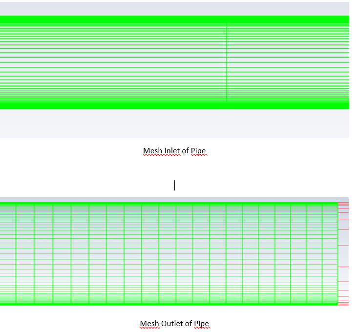

SubscriberThanks for the infromation Rob. I will try it with Mass Inlet instead of Pressure inlet. As far as the Mesh is concerned, I have tried to make it refined keeping in ind the boundary layer effects and more no.of cells towards the outlet of the pipe.

Forum ModeratorOK, first problem is the mesh. Given the flow may well change in the "along" direction you need to have an aspect ratio near one. Inflation is good for when the flow gradient wall>core flow changes but "along" doesn't: that's not the case here.Â
Liquid density can't be a function of pressure unless you're using the compressible liquid option: there's a note in the UDF manual somewhere. It's linked to the way Fluent calculates the cell mass balance.Â

Firstly, I will update the mesh and try to bring the aspect ratio of the cells near to 1 along the length of the pipe.
Secondly, according to what I understood from your 2nd paragraph about the Liquid density, shall I then keep it as constant without any UDF library? But, my UDF for liquid density varies with tempearture amd not pressure for both the liquid and the vapour phase.

Forum ModeratorOK, density with temperature is fine, but check there aren't any odd regions in curves if using a polynomial. I see far too many with far too many significant figures and T^12 terms......Â

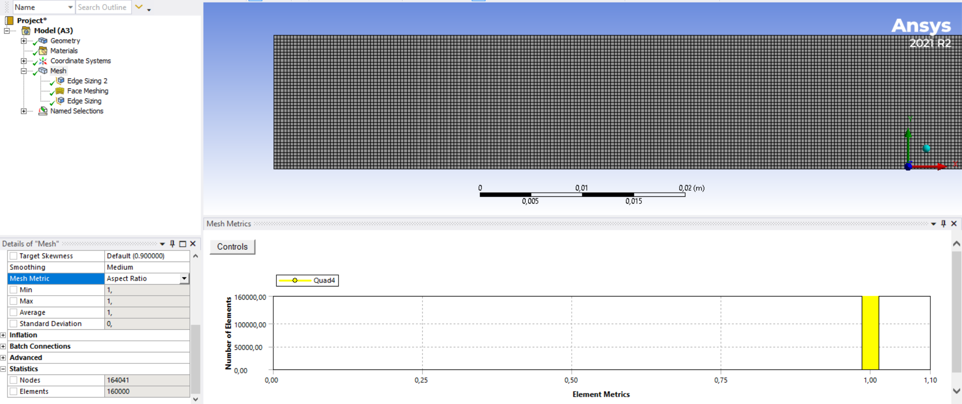

Forum ModeratorMesh looks OK. You really want to be using 23R2 or (very soon) 24R1 though. The phase change models have been seeing a lot of development attention.Â

Forum ModeratorI'm always wary of the cavitation models. The mesh looks OK, so it's now a case of understanding how the model(s) work, and also any settings that are present. When you say you're not getting what you want, what are you seeing?
