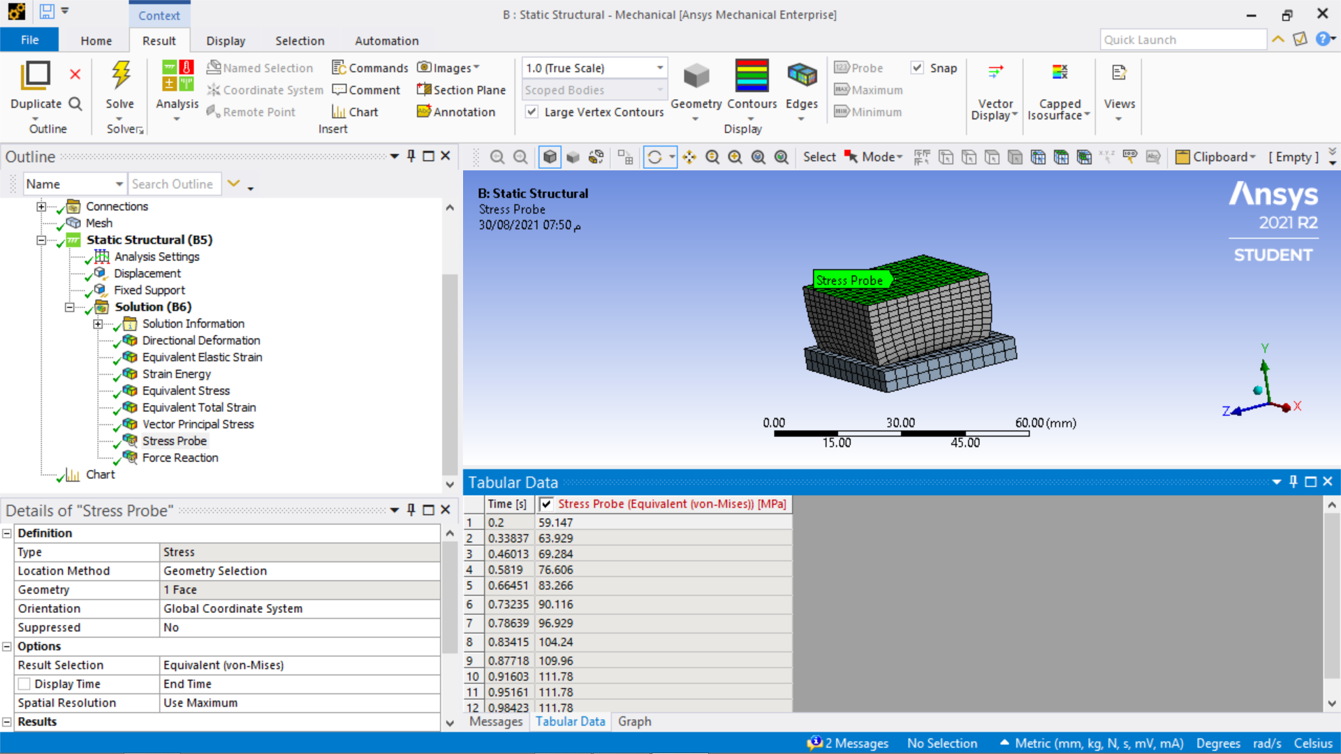

      I am attempting to model the compression of a simple cube made of ABS material and obtain the stress strain curve and compare the simulation with the experimental data.
      I have made compression samples and obtained the true stress and strain and used an isotropic multilinear hardening model for plasticity.
      should I use static, quasistatic, explicit to simulate this. I tried static and in the results couldnt see the elastic region of all curves.

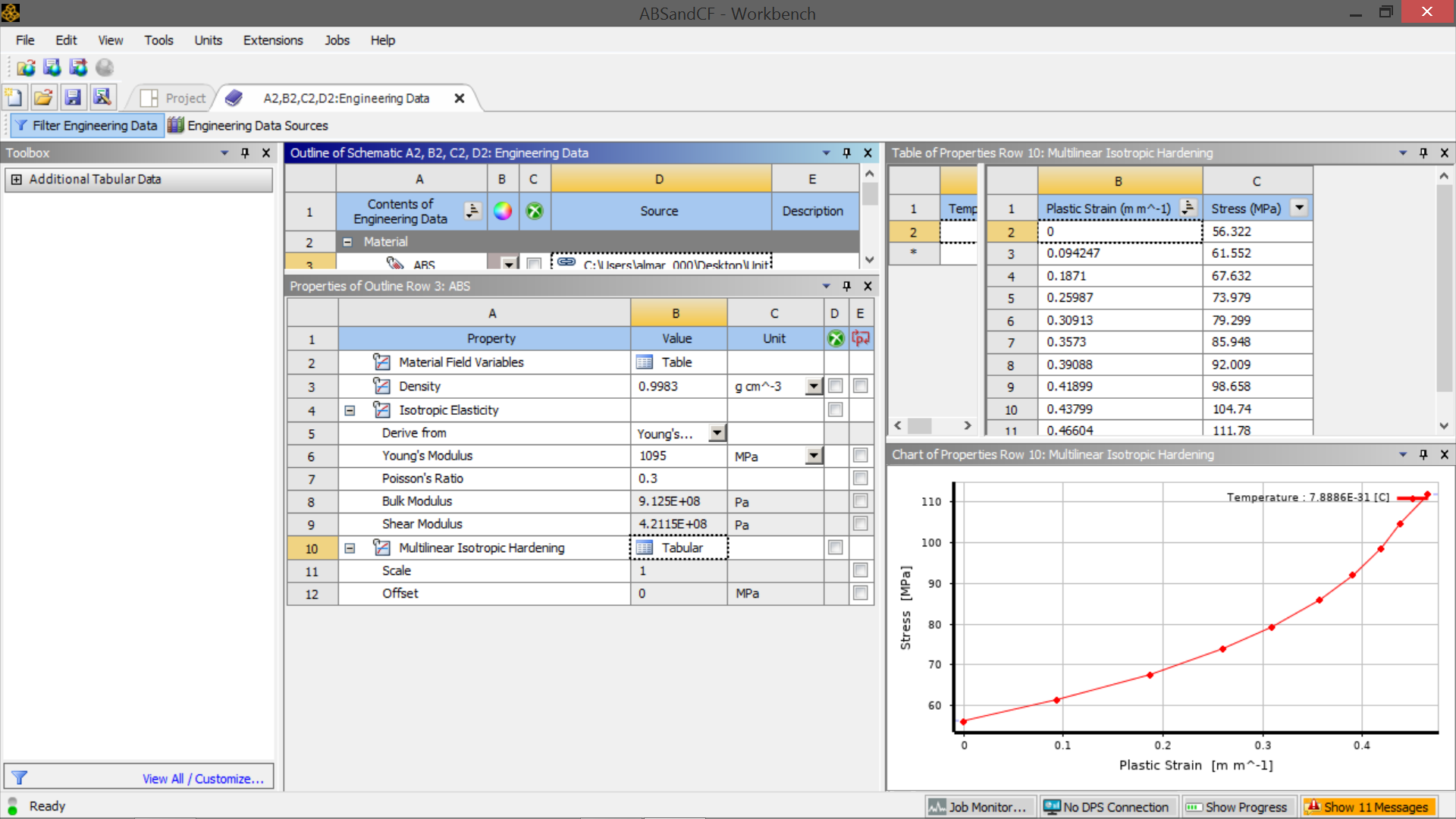

    • salmarzooqi
      Here also is the material model
