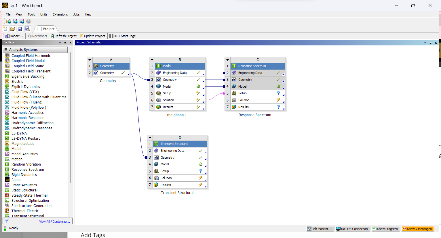

      i'm working on simulating cubesat's shock response during its launch. Although I have read many documents, I still do not understand how to make the shock response spectrum in shock response. Or can someone give me the steps to simulate it. I'm working to simulate models and don't know what to do next with them.

      A Shock Response Spectrum can be created with the APDL command, RESP,  using the transient time-history.  A blog on this topic is pasted below.
      In the input below the POST26 RESP command is used to compute the shock response spectrum for a 20g triangular acceleration of 10 milli-sec duration.  The time-history includes time after the shock load for the lower frequencies to reach their peak displacement value.  The input assumes that a modal analysis has been done and expanded.

      So with 15 or 20 lines of APDL input you can create your own shock response spectrum based on any arbitrary shape, peak value or duration of loading.  To provide a complete overview of the spectrum process the commands below retrieve the spectrum values into an array named SRS and input the values in a sample spectrum analysis.

      • BÙI HIẾU
        Thank you for your help. I will try it
