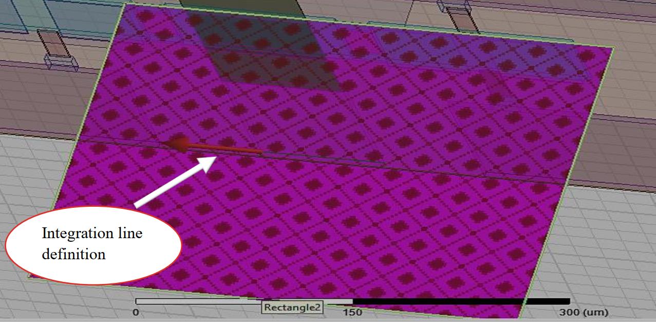

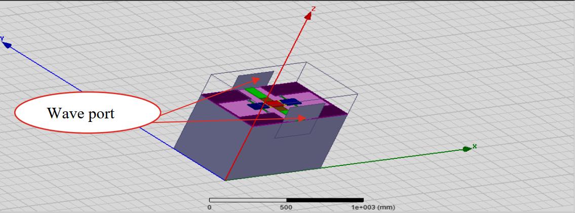

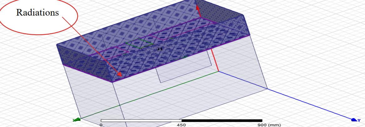

      @Peter. Thank you for getting back to me. The geometry was not imported. I made it myself in an attempt to recreate another researcher's work on a switch. The design is in no way my own and all credit is due to Miss. Sadia Yonus. I have attached images of the switch I have attempted to recreate.
      The boundary conditions: All faces selected and assigned radiation
      Excitation: Waveport with integration line defined from signal to ground and number of modes 1.
