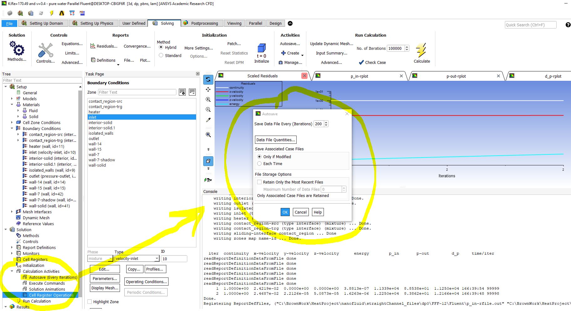

Now I again have a simulation crash, fortunately, I was saving each 200 iterations, how can I retrieve the simulation results?Â
The video that Mr Amine is sharing only shows the autosave options but not the retrieval.

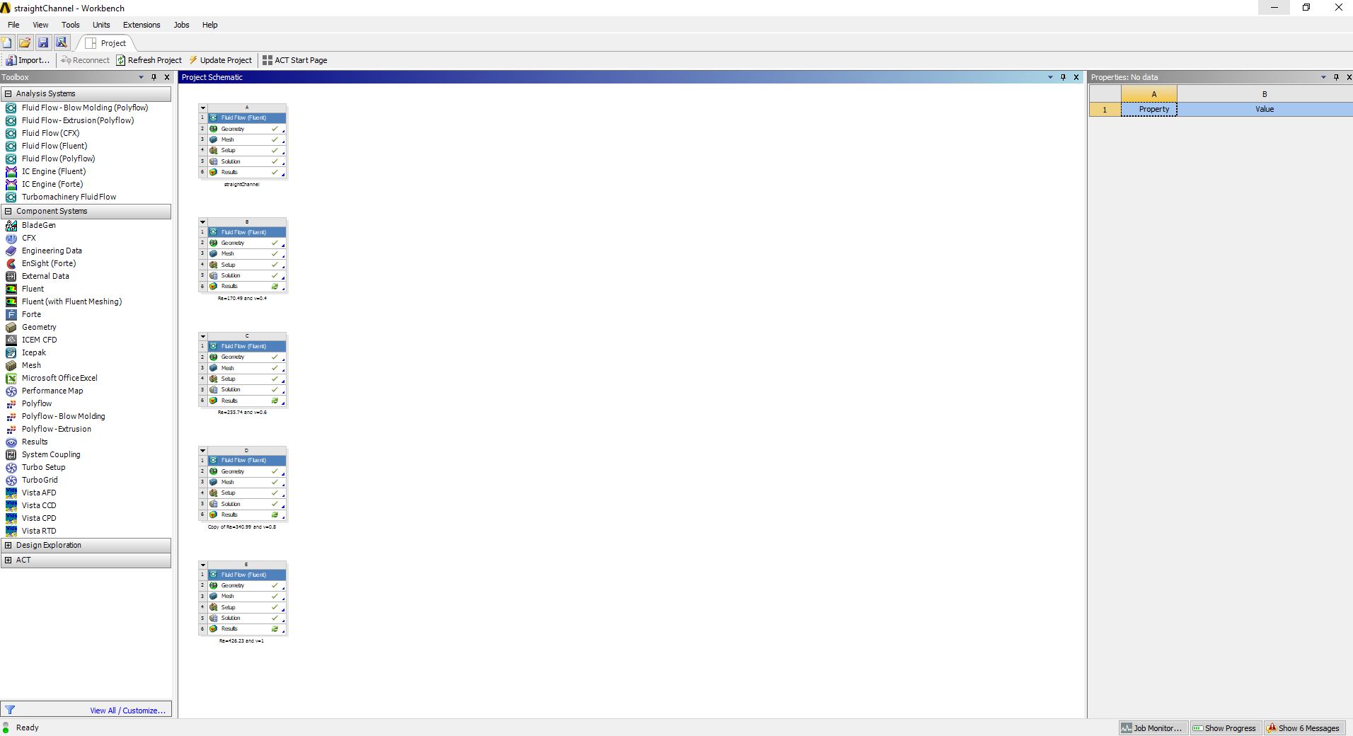

SubscriberI have also another question, I found this article http://www.padtinc.com/blog/the-focus/save-save-save-setting-up-a-save-after-solution-in-ansys-mechanical that encourage the use of "Save Project After Solution". This option I found in Mesher component so if I assume it will be applicable to the fluent component attached or reads from that mesher module. Now if the workbench has many modules (for example 5 modules as shown in the following screenshot ), is there any option in workbench that saves the complete project after finsihing the simulation of any fluent component that was running. Â

January 9, 2019 at 3:56 pm
Amine Ben Hadj Ali
Ansys EmployeeUnfortunately there is no similar option for ANSYS Fluent. You need to enable "AutoSave" in FLUENT to always have a backup. Better is to include a calculation activity in a Fluent Workbench script to save the project. This would automatically trigger Fluent to save case and data file.
The option you are talking about cane be found in DM and SpaceClaim DirectModeler. Both make a sort of AutoSave.

Now I wanna retrieve the last result before the crash, I was autosaving every 200 iterations? How to do that?

Amine Ben Hadj Ali
Ansys EmployeeThis would recover Fluent case and data but not the Workbench project itself. You can that manually but it might result in corrupt project. That is why I mentioned the scripting trick.Â

Rob
Forum ModeratorThat's not quite straight forward. Using File Manager go into the Workbench folder and look for the FLU directory. Depending on how many workflows you have you may find a few of these: you're looking for the one with lots of files with SYS.1.2.0100.dat.gz or similar. Copy that entire folder somewhere safe: do NOT move it!Â
From the Start menu open Fluent and navigate to the copied folder & launch Fluent. Use File -> Open Case to find a case file and then File -> Open Data for the data file with the highest number after it. This should be the last saved point and (with some changes to paths) you can continue to run or post process.Â
The reason for copying the files out of Workbench is if you open the Setup cell or open the wrong data file from the Solve cell you can cause files to be deleted.Â
