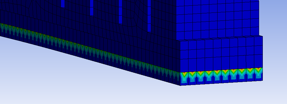

SubscribernnApologies for getting back to you so late. Thanks for the suggestion. I have attached some pictures of what I did.nIn the first two pictures, you'll see the bottom layer of the Pneu-Net. On the face of this, I have added a surface coating with 0.1mm thickness.n

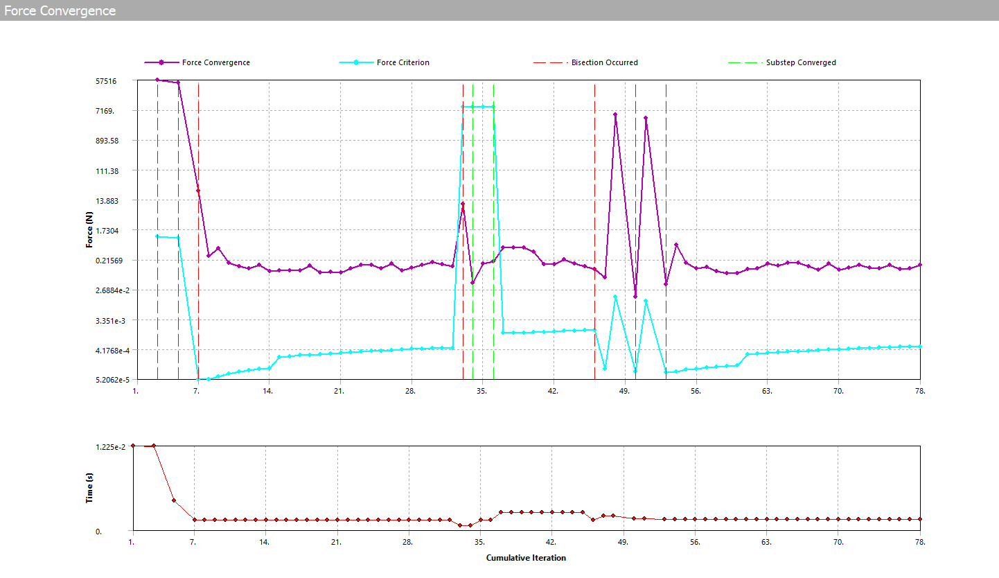

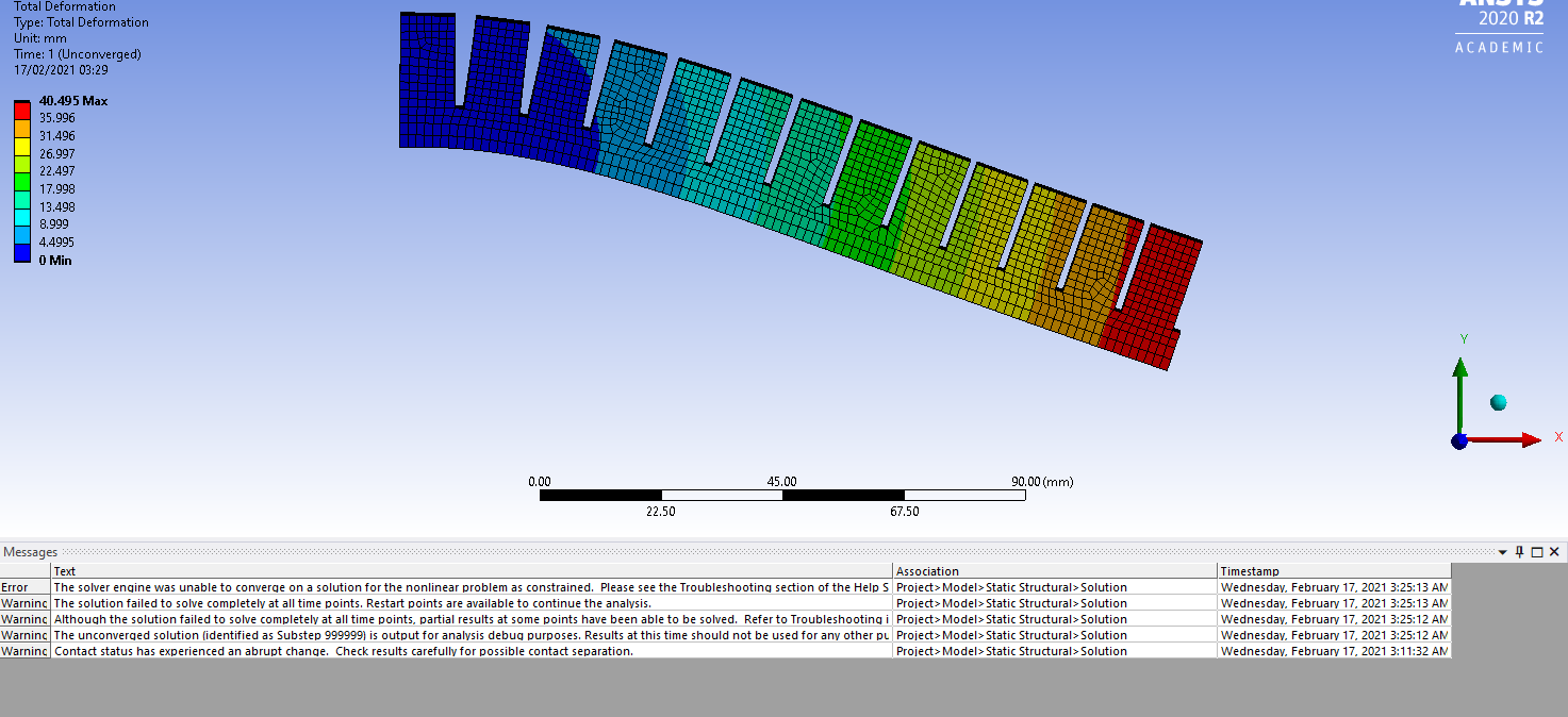

Finally, I have attached my unconverged solution:n

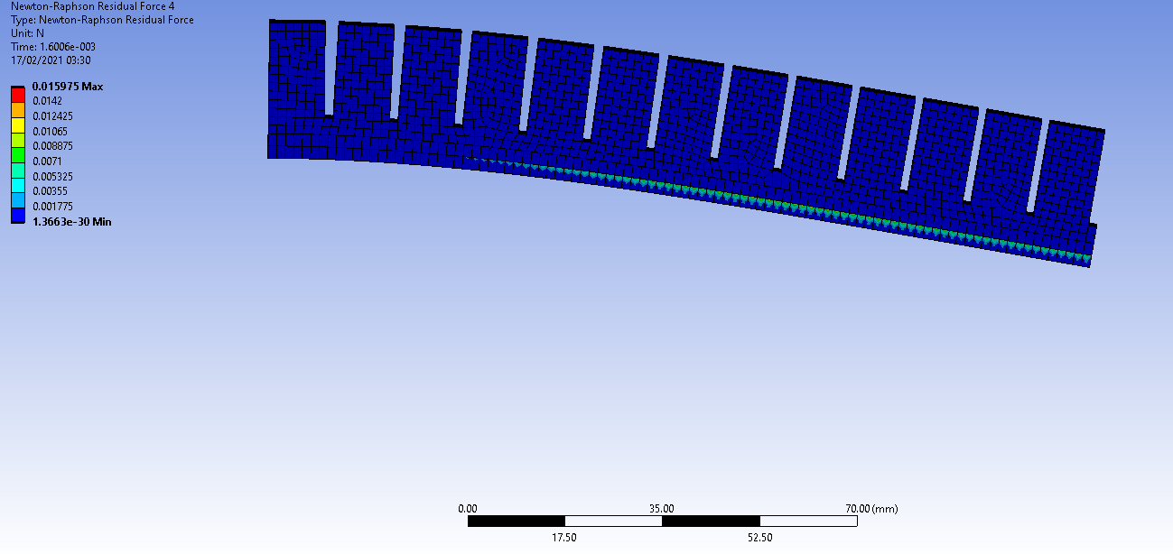

The force residuals:n
And finally, the Newton-Rhapson residuals:n
Zoomed in:n
