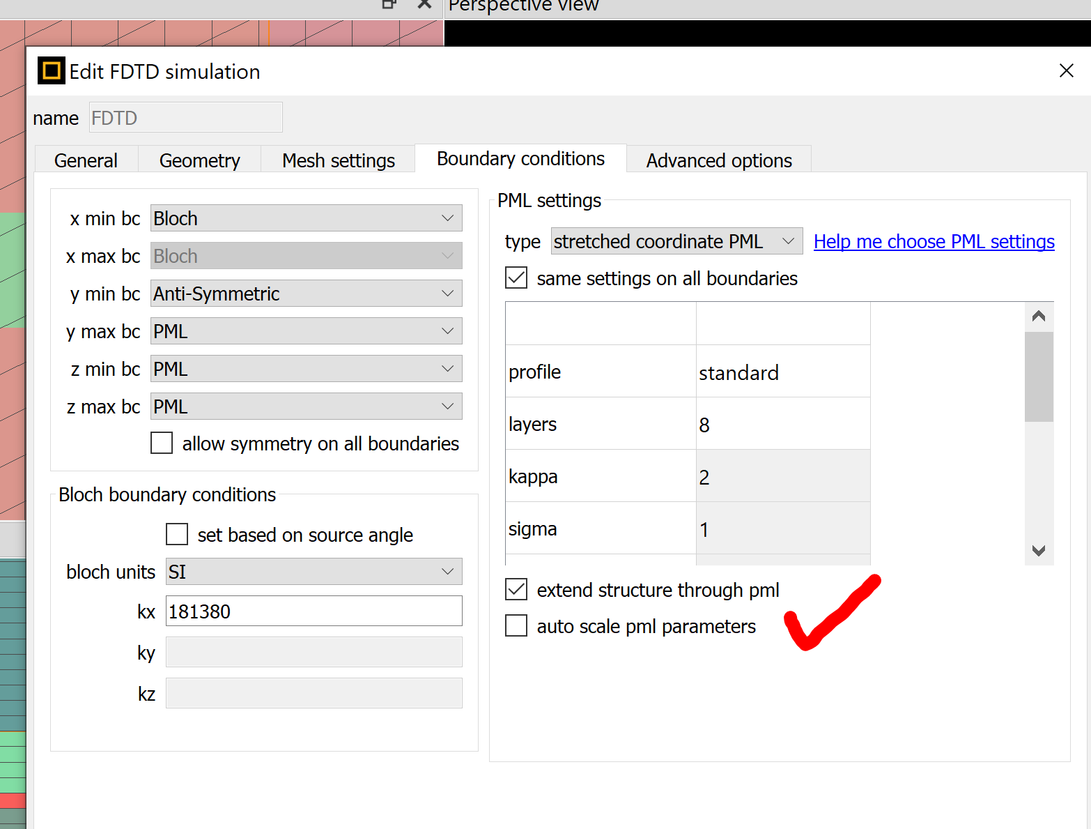

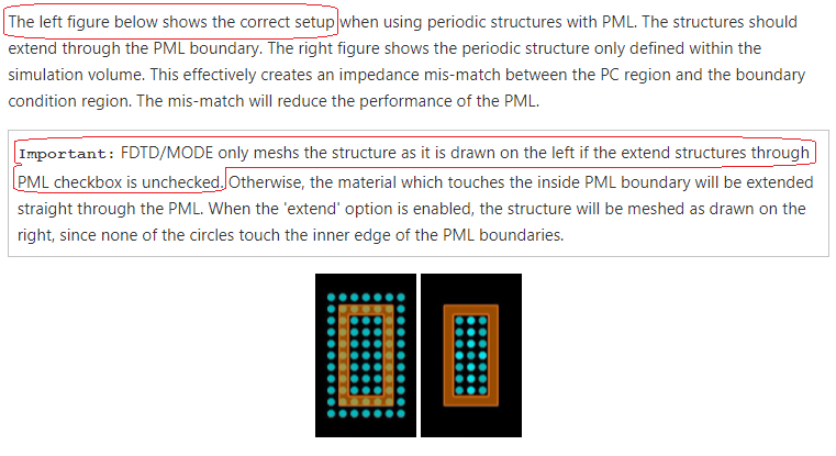

I'm doing simulations of light propagating in photonic crystal waveguide (air holes in a suspended membrane).
When I downloaded the online example - I noticed that in the boundary conditions tab of the FDTD options, the "extend structure through pml" option is enabled.
This seems to be in contradiction to what I read about in the post here:
March 24, 2022 at 9:47 pmGuilin Sun
Ansys EmployeeThank you for raising this issue. You are right!
As in the page Always extend structures through PML boundary conditions ÔÇô Lumerical Support when the "extend structure through pml" option is enabled it assumes that the structure in front of (adjacent) PML is the same as inside the PML. However for photonic structures it is better not .
Through the years there are many improvements and default setting changes. Although this option has been there for long time, many users may just ignore it, which causes some problems. So later versions evolve
to have ""extend structure through pml" option as default. Coincidently this example was developed after this default change. The example developer might not notice it.
Photonic crystal waveguide is very special, as in real world we would have another regular output waveguide on the right hand side. So your simulation is just a kind of "artificial". It is the PML along the propagation that matters and cause the issue. Depending on your simulation purpose, you may
1: simulate the whole device with regular output waveguide
2: modify the PML to have more absorption for your current settings. The newest version has this feature:
ÔÇ£auto scale pml parametersÔÇØ.
Please note that due to the Bloch wave nature, the transmission in your current settings will have some change when you change the monitor location, even the PML does not change. This is why #1 is recommended.

"1. simulate the whole device with regular output waveguide" - do you suggest to terminate the photonic crystal structure at some x value and continue with a facet or a uniform ridge waveguide?
"2. modify the PML to have more absorption for your current settings. The newest version has this feature - auto scale pml parameters"
I read only yesterday about this new feature in the release notes of ver 2022-R1.1 and I saw your team updated the documentation on the FDTD options.
Do you mean that the PML will perform better over a long periodic structure when "extend structure through pml" option is disabled and "auto scale pml parameters" is enabled (unlik in the above image)?
Does that mean that in a simulation without the new feature I should (theoretically) be able to find some configuration of pml and dt factor (<0.99) for which the simulation would run correctly and without convergence issues?

Do you mean that setting "auto scale pml parametersÔÇØ to enabled and setting "extend structure through pml" to disable (unlike in the image above) will allow me to run the simulation correctly with an extension of the structure into the pml layers (like in my image), without convergence issues?
Does that mean that if I use FDTD without the new feature, I need to find (by trials) some configuration of pml layers and dt factor (<0.99) for which I will get a stable simulation?

Ansys Employee"Do you suggest I should terminate the periodic structure at some x-position and couple the light into a uniform waveguide?"
Yes.
"setting "auto scale pml parametersÔÇØ to enabled and setting "extend structure through pml" to disable (unlike in the image above) will allow me to run the simulation correctly with an extension of the structure into the pml layers (like in my image), without convergence issues?"
It is not guaranteed. But you can try.
"Does that mean that if I use FDTD without the new feature, I need to find (by trials) some configuration of pml layers and dt factor (<0.99) for which I will get a stable simulation?"
Yes, most likely you have to modify the PML settings.
"I didn't show any monitors in my image. What monitor are you referring to?"
I believe your ultimate goal is to measure the transmission, not simply to get a converged simulation, even though your current settings have no any monitor except the incident port.
"I assume that with correct PML layers there should be no back propagating waves and so the field distributions will represent the forward propagating modes (my geometry is tuned to have single mode operation at the wavelengths of interest)"
What the mode do you mean here? inside the injection regular waveguide or PhC waveguide? You know inside photonic crystal they are Bloch modes, which means they are volumetric, not planar field distribution. not sure how do you justify it is forward propagating as it has lattice resonance (I called them from my previous research), eg standing waves. How do you know it is single mode? I think this is a more theoretical issue. Even if there is one mode as you expect, if the transmission is close to zero, do you still want it? This paragraph is purely my personal view and suggestions. you can ignore this.
Discrete PML does not absorb 100%. It has discrete numerical errors. IN some case its reflection can be neglected but in other cases it can be significant, even the simulation converges.
Please note that anything changes such as the PhC waveguide length or width, you are simulating different devices in the eye of FDTD.

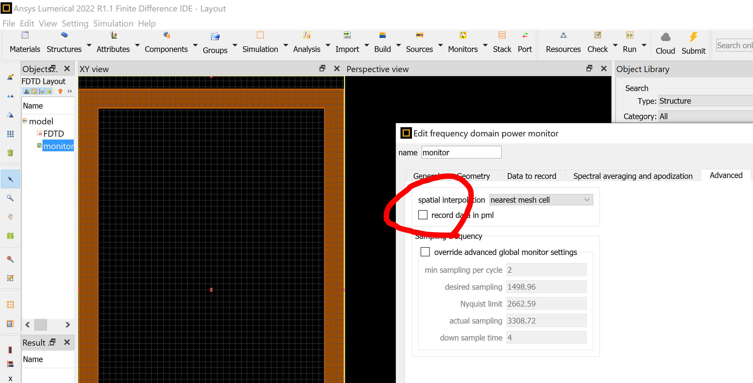

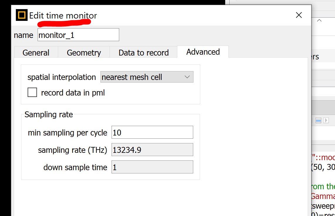

Roughly speaking, the shutoff level is a ratio of the residual energy inside the simulation file over the injected energy. In your case, it might indicate that the energy is trapped inside PML.
Please enable the monitor to record the data inside PML:

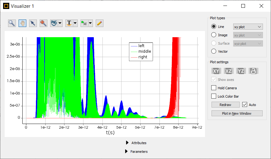

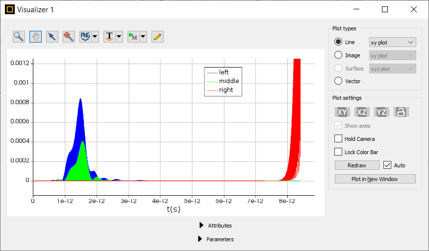

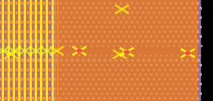

SubscriberI placed several monitors in the PML, 3 of them along the "waveguide core that is in the PML"
The power data from these monitors is below. It appears that there's energy build-up at the edge of the PML (the right monitor).
I thought that as the EM radiation propagates along the PML it's absorbed, so when it reaches the edge of the PML it has little energy left. I also expected to see a weak pulse in the right monitor that appears around time moments 2psIn any case, it looks to me like even though shutoff condition isn't reached - the problem of energy diverging is confined to PML only, so the data collected within the DTDT region within the simulation time is valid. Is that a correct assumption?
April 5, 2022 at 7:07 pmGuilin Sun
Ansys Employee"I thought that as the EM radiation propagates along the PML it's absorbed, so when it reaches the edge of the PML it has little energy left. I also expected to see a weak pulse in the right monitor that appears around time moments 2psThis is the root cause of diverging inside PML.
"In any case, it looks to me like even though shutoff condition isn't reached - the problem of energy diverging is confined to PML only, so the data collected within the DTDT region within the simulation time is valid. Is that a correct assumption?"
This will depend on when the simulation terminates: if it terminates before the "burst of power" returns to the simulation region, the monitors inside simulation can give reasonably accurate results. However, since light travels fast, usually the problematic "burst of power" will enter into the simulation region and the results in monitors will not be reliable. That said, you could terminate the simulation around 7e-12 seconds where autoshutoff level is low. This is only valid based on the information you provided. Please check if any other time monitors can have low signal strength around this simulation time.
