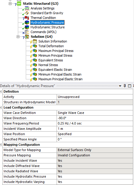

I am working on a floating structure analysis and need to simulate mooring effects in ANSYS Static Structural. I have the hydrodynamic stiffness matrix from AQWA output files and would like to understand the best approach to implement it in a static structural analysis. Or just the pressure mapping is enough to simulate tthe structure with the moorings already defined in diffraction model?                                                                                     Â

If you want to include mooring loads in the structural calculation, the best approach may be to map from a time domain Hydrodynamic Response analysis to a Static Structural analysis. In the Analysis Settings of the time response analysis the Analysis Type should be set as 'Irregular Wave Response' or 'Regular Wave Response', and the structure(s) should be selected in the Time Domain Pressure Output settings. Then the time domain cable forces can be directly applied to selected locations on the structural model. Please see this section of the Aqwa User Manual for more information.

March 26, 2025 at 4:31 pm
arjun.janardhanan
SubscriberHello Mike,
We have updated Ansys to 2025 R1, and now we cannot manually select "Model Type for Mapping" to "External Surface only" as the structure has reinforcement line bodies. It is automatically set to "External Surface and line bodies", which now gives an error that "It is not possible to map loads on to Solid Bodies and Line Bodies". In 2023 R1 we were able to manually set this, even if line bodies were present. How to solve this or is it better to use 2024 R2? (In the image I have supressed line bodies and now it automatically sets to "External Surface only")

April 9, 2025 at 2:30 pm
Mike Pettit
Ansys EmployeeHello,
Sorry it has taken a little while to get back to you on this one. There is a way to work around this in Release 2025 R1: You can add a Mesh > Pull > Surface Coating in Mechanical, then scope the Hydrodynamic Structure surface selection to the surface body created by the Surface Coating operation. Or, you can use Release 2024 R2 if that is more convenient.
It seems like you are now forced to map to Line Bodies if they exist in the Mechanical model, so I'll try to get this fixed for the next release. You can always scope the Hydrodynamic Structure line body selection to any line body that is not in the water, if needed.
