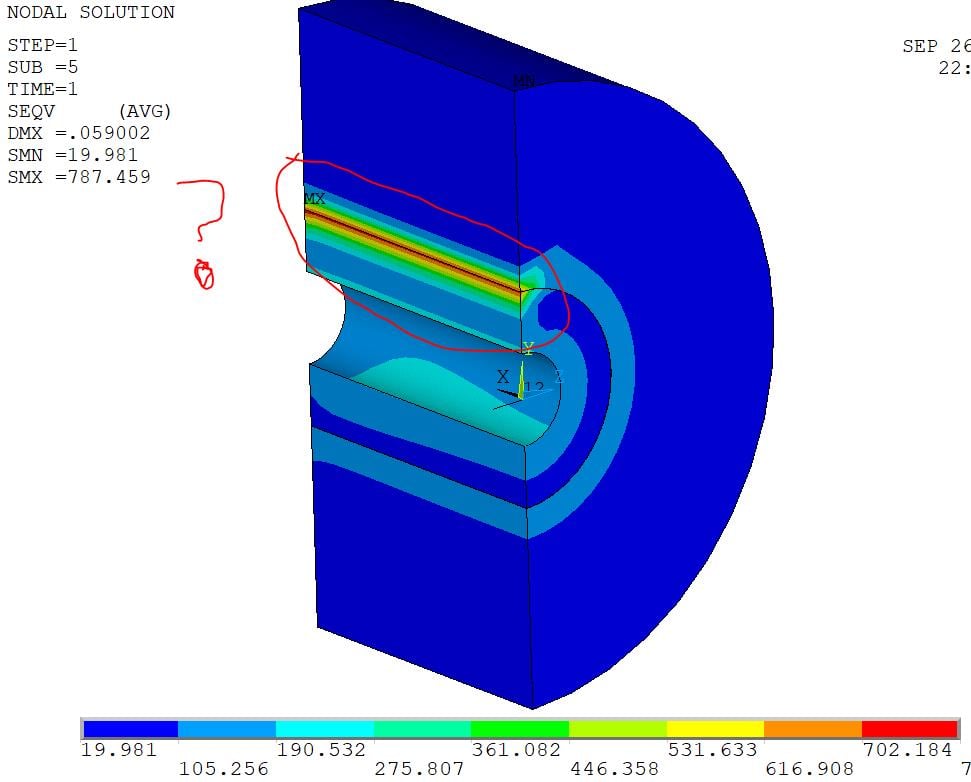

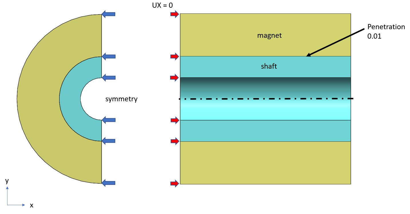

      Hi all,
      I need to do a simulation to see the effect of interference fit between two components. I can very easily do this in workbench, but I'm having some troubles to do this in APDL. For this assignment, I have to do it in APDL.
      The following is the results I get, which is not correct and I cannot figure out why does this happen.
      I have also attached the APDL code I've used.
      Thank you.

    • Rashi
      I found an error and fixed it.
      The symmetry was defined in the wrong direction, so I fixed it as shown below.
      DSYM,SYMM,X,0 > DSYM,SYMM,Z,0
      But I still get results which are not correct.
    • Rashi
      Since defining interference fit in contact did not work I specified the interference in the geometry. Then I was able to get satisfactory results. Now I need to do the following,
      In WB we can specify a remote point to a set of nodes and specify the DOF to the remote point. How can I do the same in APDL? Is there a way to couple a keypoint and set of nodes?
