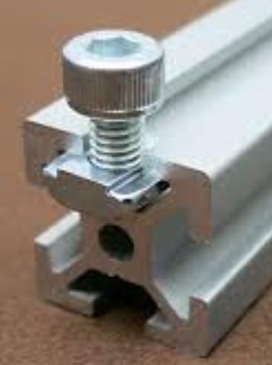

SubscriberA Tee bolt that was slid into the slot of an extrusion has a nut that was torqued to create a tensile stress in the shaft of the bolt to clamp the two 8020 extrusions together.
Where is the nut in your model?
ANSYS Mechanical has a load called a Bolt Pretension. One way you can use this is to use Bonded Contact to connect the nut to the shaft of the bolt. The bolt shaft should have the face split at the face of the nut. That separates the face bonded to the nut from the face that has the Bolt Pretension applied. Frictional contact between the Tee head is as you have created, and you do a similar contact between the nut and its contact face to the extrusion.
Or perhaps the extrusion has threads cut into it and the Tee has a hole in it to allow a circular threaded fastener to pass through the Tee and reach the other extrusion. It's not clear from your image if this is the configuration of the joint.
Or there is the option shown in the image below where the Tee is the nut.
In either case, you use a two step solution. In step 1, the bolt pretension is applied while the frame load is kept at zero. In step 2, that pretension is set to Lock and the frame load on the 8020 is applied. The contact force of the two faces of the 8020 that were clamped together by the pretension is what supports the load applied to the frame.

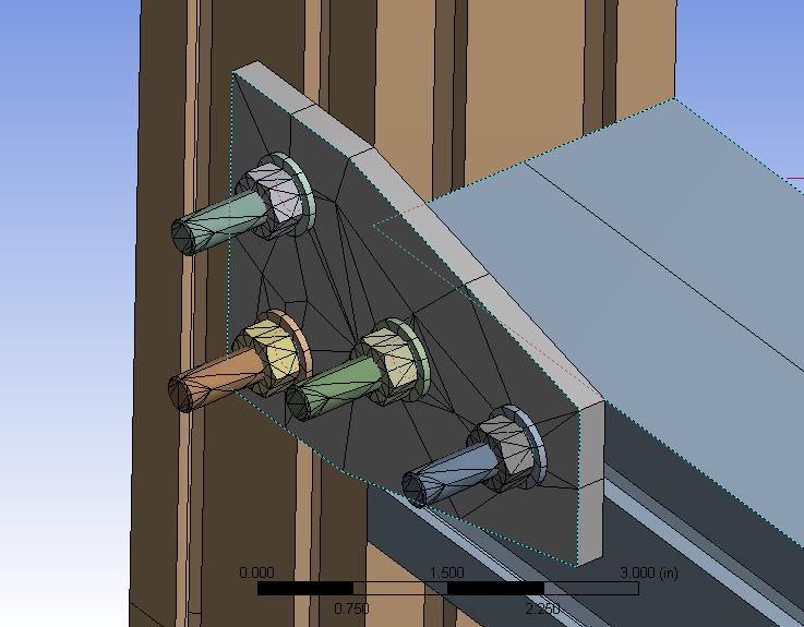

SubscriberThanks for the help Peter. I made a few design changes based on what you said (specifically the nuts) and added a pair of plates to better support the 8020.
The problem I'm experiencing now is that as I am using the ANSYS student version, I'm limited to 32000 nodes. I don't want to increase the mesh size too much, however, as it will make the results less accurate. Is it possible to have one mesh size for the fastener and plate parts while having another for the 8020?

It is difficult to keep under the Student limit for problems with contact. Here are a few suggestions.
Use Symmetry if your geometry and loads are symmetric
Cut the Tee bolt length at the end of the nut, the extra material is not relevant.
Combine the washer and nut into a single body, just make the washer the height of the nut.
Cut the 8020 down to short stubs.
Regards, Peter

Forum ModeratorHi Tom,
In addition to Peter's suggestion, to limit the model size - you may use a linear mesh with good mesh density in the regions of interest.Â
