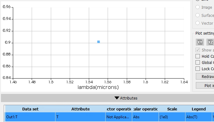

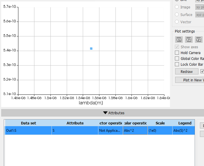

    • minusunny
      No they are different. Please see the results:
      Abs(T) = 90% whereas abs^2(S) = 5.4e-10

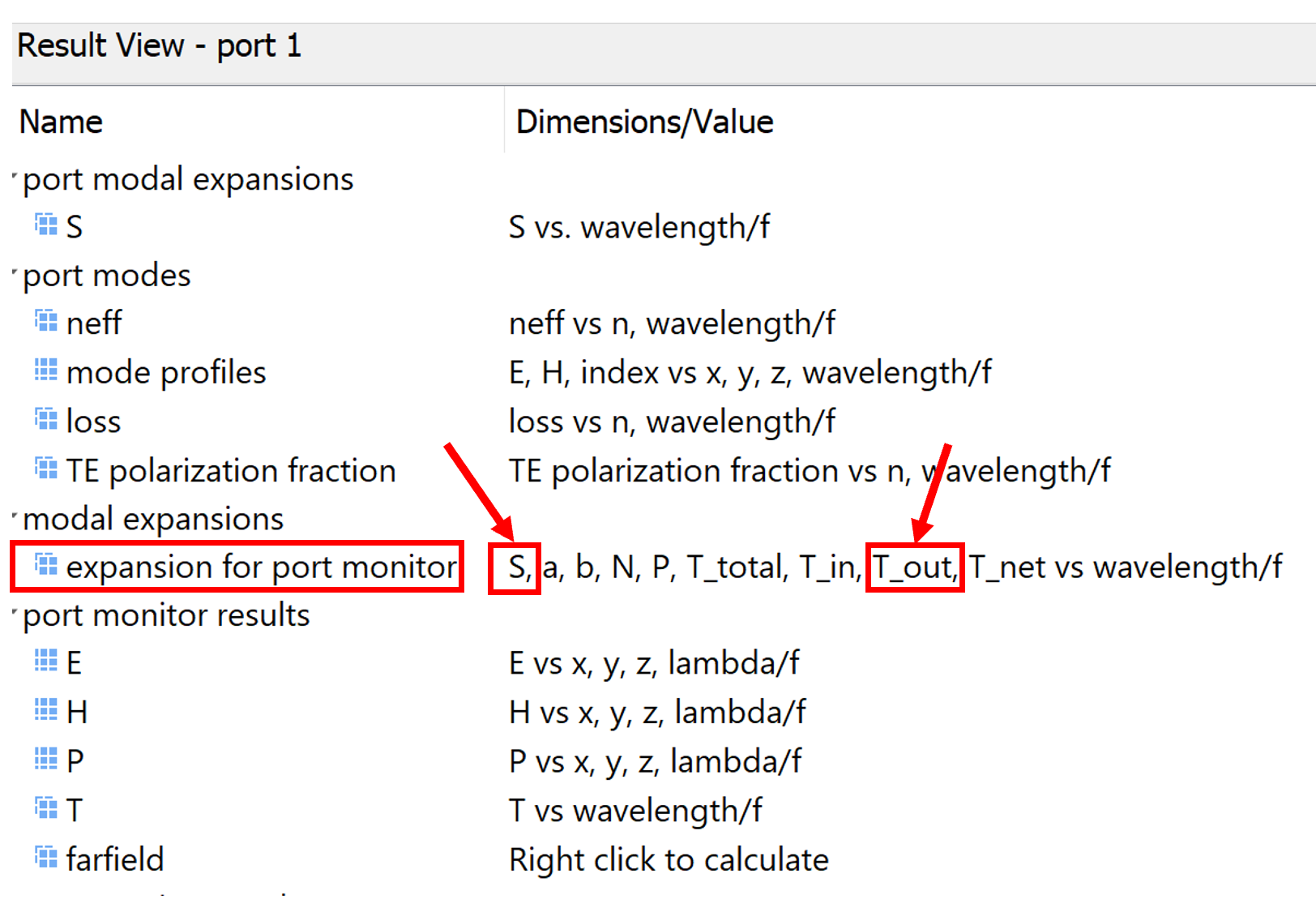

    • Afroditi Petropoulou
      The results that you have plotted are from the "expansion from plot monitor"?
      The results that should match are the following:
      If you are looking at the "T" result (which is the same as the T_total result from the expansion for port monitor) you will not get the same results as abs(S)^2, since S gives you the power that reaches the port from other ports. For example if you are looking at the port that is used as a source, the T result will be close to 1 (since light is injected from this port) but S result could be almost 0 as it is the result of the reflected light that gets back to this port. T_out result though, is the transmission at the direction of the red arrows shown above, which is what S parameter calculates.
      If T_in result at the source port is not exactly equal to 1, but 0.99... then the results that would match are abs(S)^2 of a specific port with T_out of the specific port devided by the T_in of the source port.
      Best Regards,
      Afroditi
