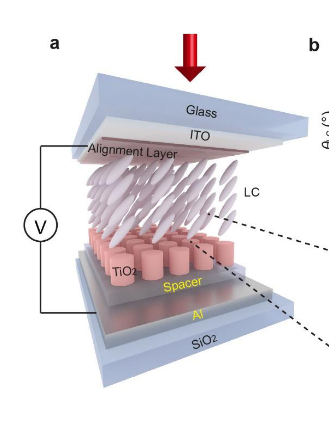

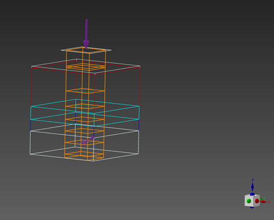

      I was trying to simulate LC rotation as this link showed [https://optics.ansys.com/hc/en-us/articles/360034915153-LC-Rotation-Simulation-object
      ], the structure is shown as in fig. 1.
      The original paper I try to reperform is
      [1] P. Moitra et al., ‘Electrically Tunable Reflective Metasurfaces with Continuous and Full-Phase Modulation for High-Efficiency Wavefront Control at Visible Frequencies’, ACS Nano, vol. 17, no. 17, pp. 16952–16959, Sep. 2023, doi: 10.1021/acsnano.3c04071.

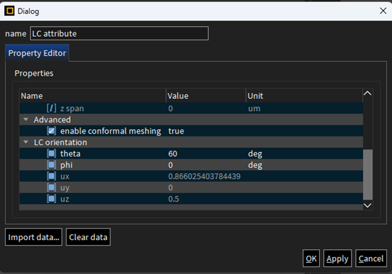

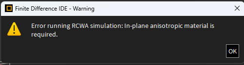

      I set the xz plane (out of plane) director orientation for 60 degrees (fig. 2 and 3), but I keep getting this warning (fig. 4). It seems that only in-plane orientation (changing phi) is allowed; whenever theta is set with values other than 0 and 90 degrees, the IDE will give this warning.
      I would like to know how to simulate out-of-plane rotation of LC within RCWA. I know FDTD can do this, but the speed is much slower than RCWA.

      Currently, the RCWA solver supports only in-plane anisotropy. Please refer to the RCWA Solver Introduction under the Supported Materials section.
      This may change in future versions, so stay tuned for updates.
