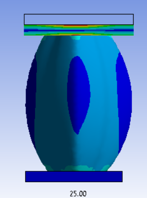

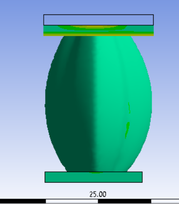

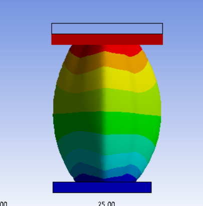

Subscriberthanks for the feedback. I followed your advice but I still cant show in ANSYS that the highest stress must be in the areas were the cracks appeared. The partial results look like this, (total deformation, maximum principal stress, equivalent stress)nn

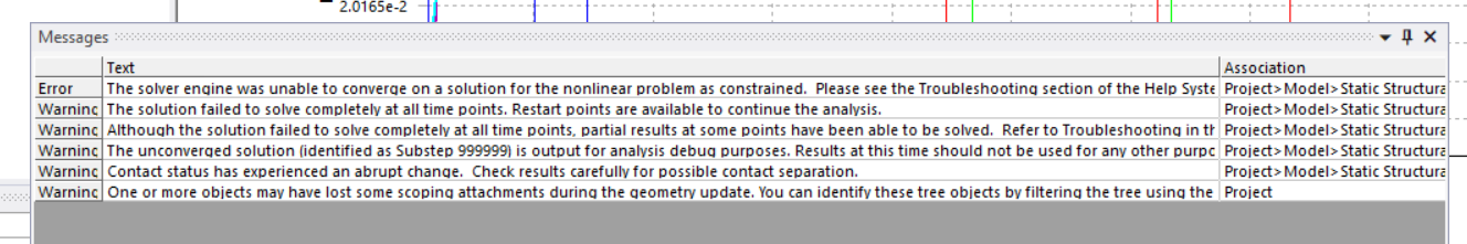

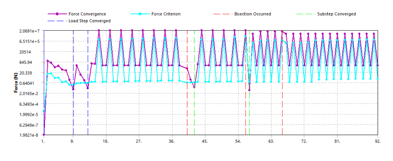

nAlso, ansys is giving me this errors, and the force-convergence graph looks weird. Please help. Thank youn

SubscriberPlease make stress plots that are scoped to the nut only and not All Bodies. I don't care about the stress in the end plates that are doing the cracking of the nut.nTurn on the Max flag and make a Section Cut view to see the distribution of stress about the maximum location on a few different planes.nI don't think it matters that the N-R Force Convergence Plot has spikes.nViewing 3 reply threads- The topic ‘Simulate Brittle Cracking’ is closed to new replies.
